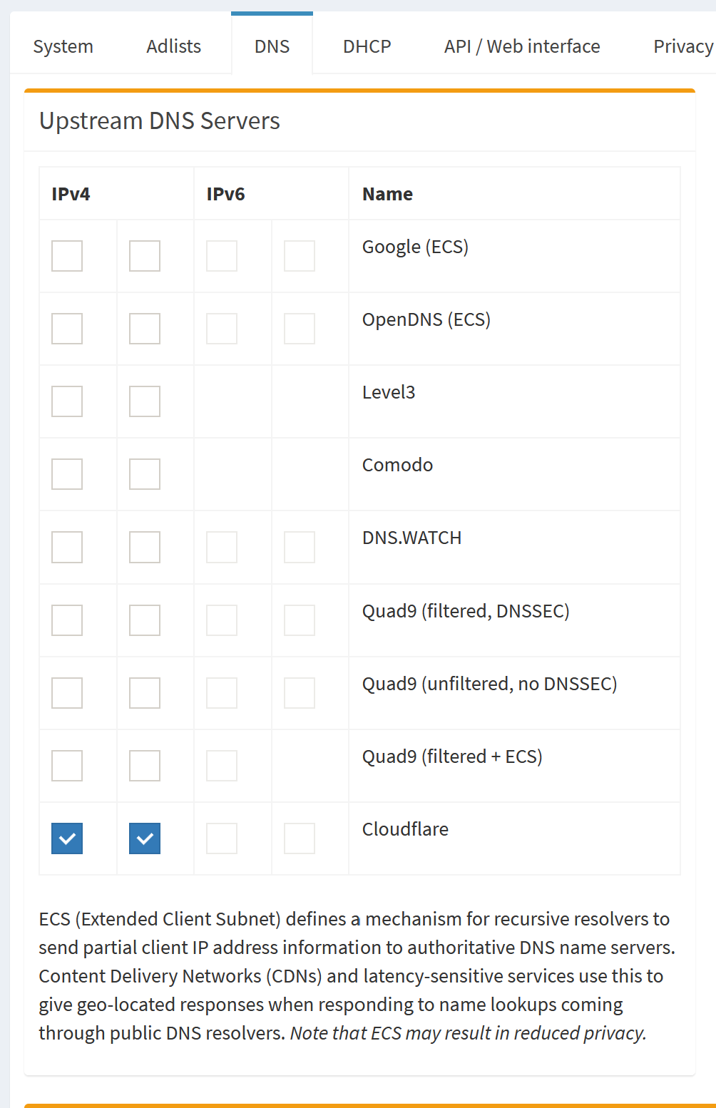

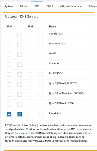

What's your Pi-hole using as upstream DNS servers?
Cloudflare. Should I be selecting something else?
No, your problem seems related to local DNS resolution, as your nslookup fails on resolving pi.hole.

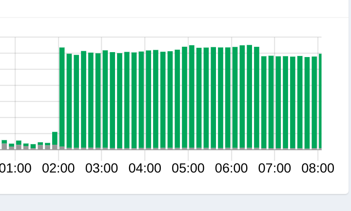

@deHakkelaar The voltage checks did not return anything, and I didn't see anything like what you posted for the oom killer, although I noticed that when it cut out this morning the dashboard showed the attached pattern of activity.

That screenshot you posted doesnt show the vertical Y axes making it impossible to see how many queries.
Did you check who made all those queries via the web GUI or checking the logs with below ?
less -p 'Oct 8 02:00:00' /var/log/pihole.log
Above one makes me suspect you have configured a DNS loop somewhere.

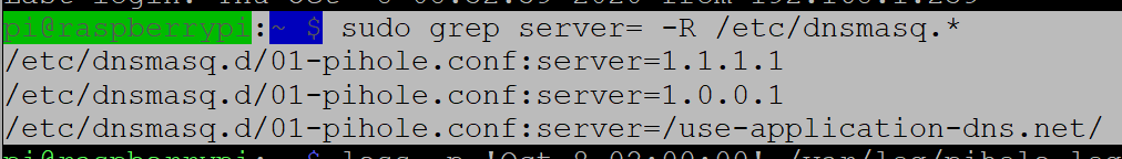

What upstream DNS server(s) is/are configure on Pi-hole ?
sudo grep server= -R /etc/dnsmasq.*

Upstream DNS servers:
When I run the code you presented, the outcome is below:

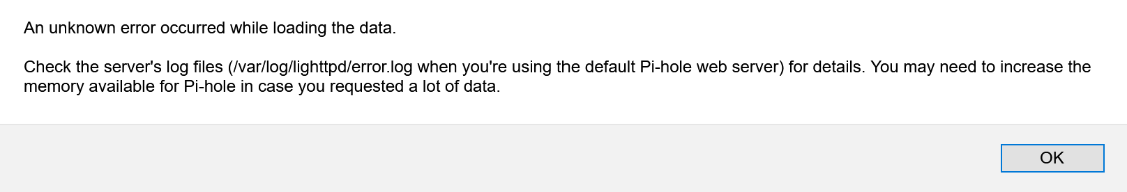

When I tried to view this month's entries, @jfb, I got this error:
If you have inadequate PHP memory, you can increase the memory allocated to PHP:
@jfb @deHakkelaar ok, having now upped my php memory to 1350 M, it looks like the biggest query creator on Oct. 8 was my desktop (61232), followed by my laptop (57153), my wife's phone (49344), my smart display (45283), my daughter's smart speaker (43106), my smart speakers (42927), office speaker (35395), my tablet (34971), the bedroom smart display (27112), and my phone (23733).

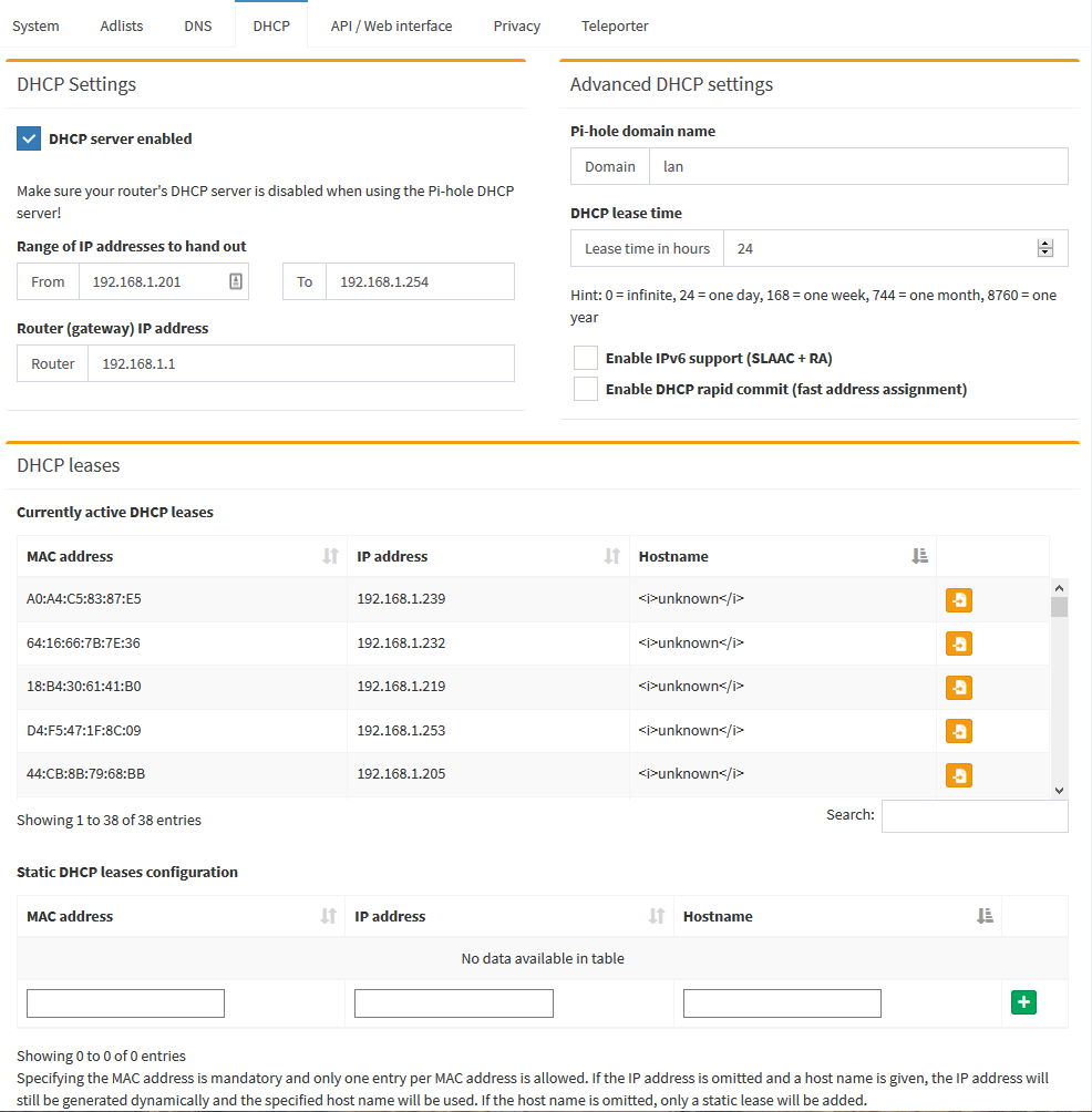

Before, it was your router at 192.168.1.1 making the most queries:
Has anything changed in that respect ?
Do you still experience "Internet Disconnecting After a Few Hours" ?

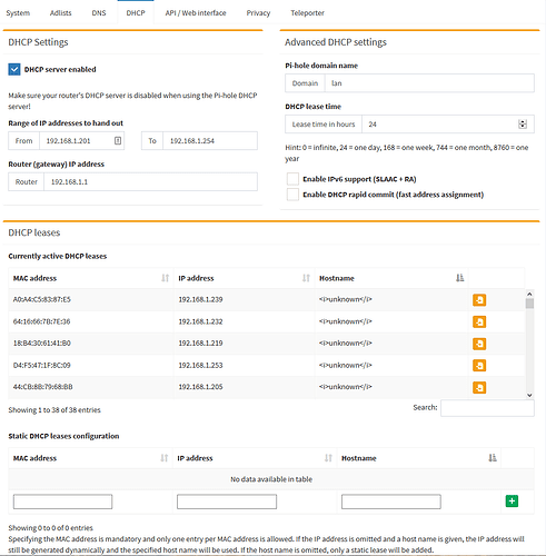

@deHakkelaar, I'm sorry, you're right. I did change it after I realized that it was easier to see activity if the pihole was providing ip addresses, so I disabled DHCP on the router and enabled it on the pihole.
However, I continue to get the timeout.
