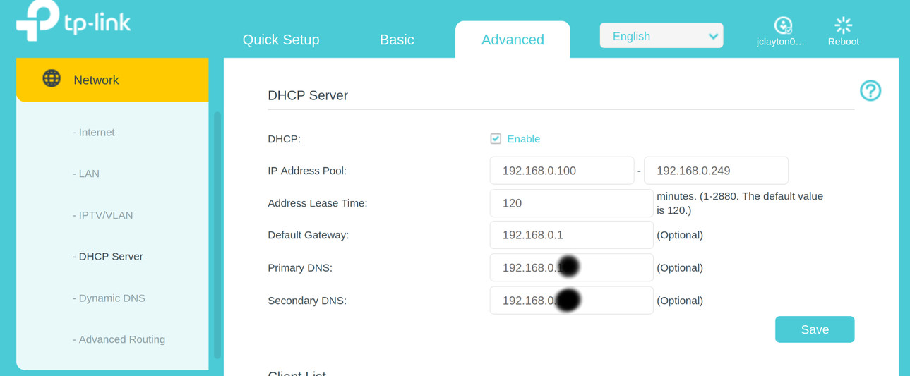

Running pi-hole v6 on Fedora 41 Workstation. Router: TP-Link Archer A10.
Pi-hole allows network traffic and resolves DNS
After configuring pi-hole as the primary and secondary DNS servers in the DHCP router settings, only the pi-hole machine has reliable internet access. I set the static IP address in both the DHCP reservations section and on the client machine, and tried it both separate ways first. I am able to ping both 8.8.8.8 and the pi-hole's address successfully from the client machines, but it seems like there is a DNS resolution issue, as google.com fails to resolve in the browser.

A dev will likely need to look at your debug but It seem like a router setting. Are you sure that the pihole is setup as the DNS server in the LAN / DHCP section and not the WAN section?

I am fairly confident I am setting the DNS settings right. I followed the instructions here: How to use Pi-Hole DNS Server on TP-Link routers
