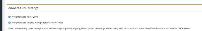

Looking at the web admin interface under Settings->DNS->Advanced DNS settings, the checkboxes for "Never forward non-FQDNs" and "Never forward reverse lookups for private IP ranges" ARE both selected.
In this case, none of your internal IP information should be leaving your network.
