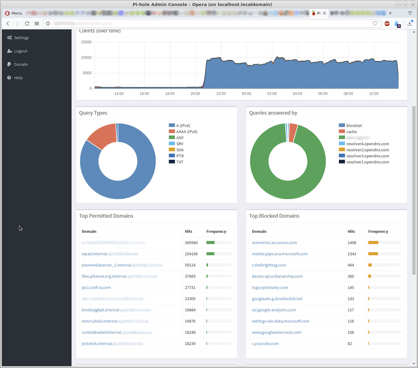

Ever since enabling Conditional Forwarding on Pi-Hole, I'm getting some strange results in the "Permitted Domains" section of the dashboard as seen in this screen shot:
Every host (whether it be internal or external is appended with my internal domain suffix).
There are also a bunch of hosts which appear that appear to be just random characters; none of those hosts actually exist.
It seems that 95% of the DNS queries are being answered by my secondary (internal) DNS server which is the green part of the graph. Before enabling conditional forwarding, this was not the case.
Any ideas?

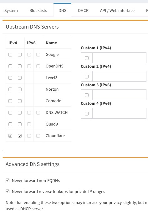

What are your settings for "Never forward non-FQDNs" and "Never forward reverse lookups for private IP ranges" on the Admin GUI > Settings > DNS page? Example below.
Never forward non-FQDNs and Never forward reverse lookups for private IP ranges are both ENABLED.
