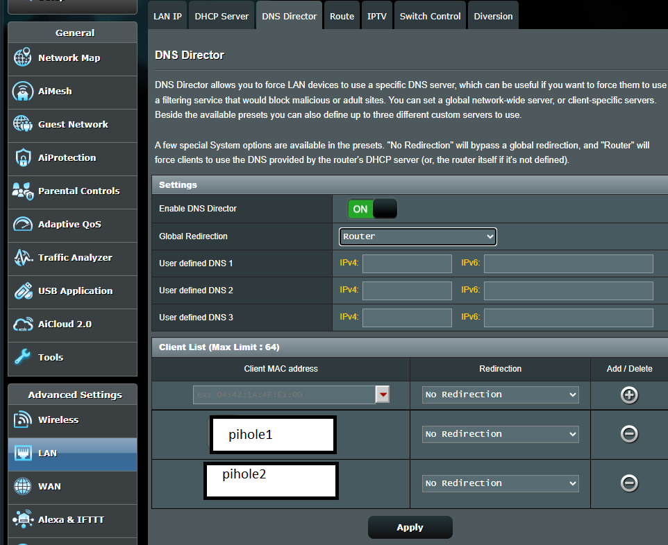

Another bit of an update. For context I am running Asuswrt-Merlin ver 3004.388.8_4.
I found this recommended set up from ASUS (using DNS pointed at Pihole on both WAN and LAN). I know this is not recommended by Pi-Hole. However, this setup seemed to clear up the issues I was experiencing. https://www.asus.com/us/support/faq/1046062/

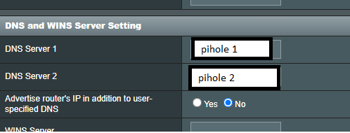

Would the set up below work better so I could better filter by client, see which client was requesting DNS?
The first image in your linked post makes sense.
Your devices will get the ip you specify under "DNS Server 1" and "DNS Server 2" as their DNS server provided from the router by DHCP.
In the second image, the dns director does not seem to be set up optimally for use with a Pi-hole.

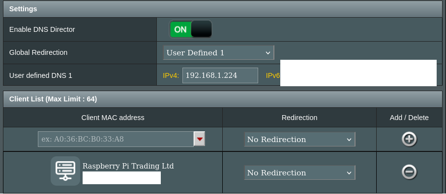

If the Pi-hole's ip is entered under "user defined dns 1", and global redirection is set to "User defined 1", DNS director will catch requests from devices that ignore the DHCP provided DNS server and send them to your Pi-hole.
(Setting it to "router", as in your linked post, instead of "User Defined 1" will instead send any of those queries to the DNS server specified in the router's wan settings. If you have the wan dns set to your Pi-hole it can cause DNS loops).
The Pi-hole should still be added to the client list and set to "no redirection" to ensure it can reach its upstream dns servers.

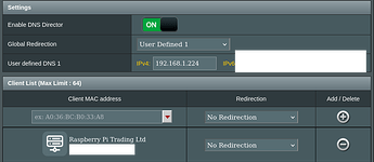

On 3004.388.8_4 I would set up DNS director like this (change ip to that of your Pi-hole):
Thank you. I believe I have everything set up correctly now. DNS requests are resolving MUCH quicker.
