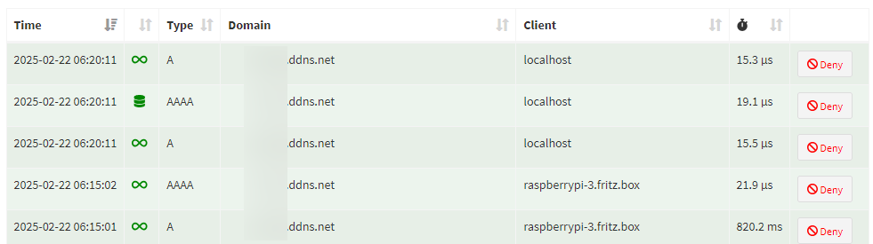

This happened last at 06:20, at which time I have this in the query log
so apparently no failure?

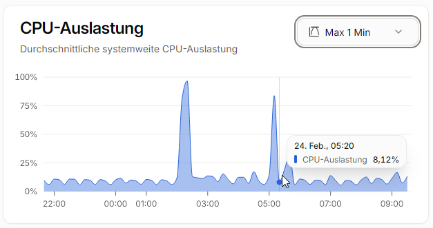

And here's the pi4's beszel graph at that time, this was not caused by a maxed-out CPU either:
Nothing strange in the syslog at that time either.

So .180 has been sending lookups, repeating and finally expanding them by the search domain, but didn't get a reply, while the corresponding requests either failed to register in Pi-hole, or did so only much later.
And as your cronjob doesn't run twice, that would suggest that curl also went into repeating its request.
This may suggest that DNS requests may have been queued.
Depending on dns.replyWhenBusy, Pi-hole may silently drop queries when writing to its database, but that would usually just take ms, unless under heavy load, and you'd still the queries registering, making it rather unlikely that's the case here.
Nevertheless, let's see how many DNS requests Pi-hole had to handle at that time.
What's the output of:
sudo pihole-FTL sqlite3 /etc/pihole/pihole-FTL.db "SELECT count(*) FROM queries \
WHERE timestamp > strftime('%s','2025-02-24 05:21', '-3 seconds', 'utc') \
AND timestamp <= strftime('%s','2025-02-24 05:21', 'utc');"
And also:
sudo pihole-FTL --config database.DBinterval

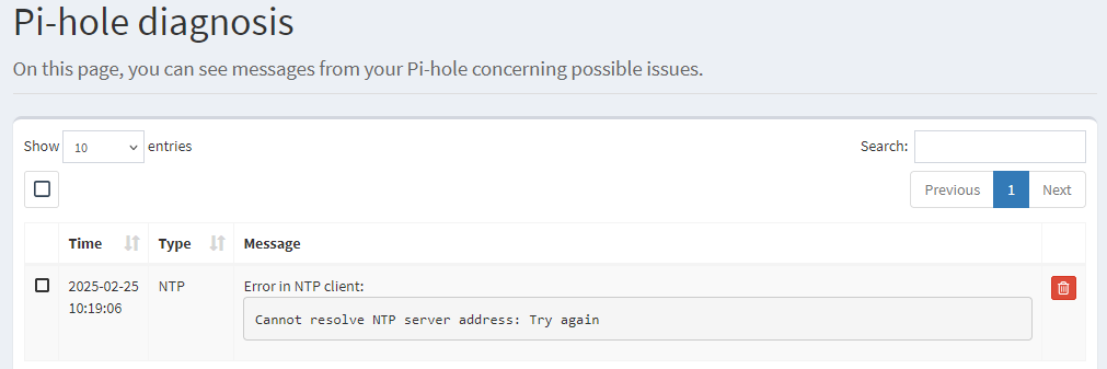

However, I'm still not convinced my pihole v6 is fully stable:
with this trace in pihole.log:
Feb 25 10:19:10 dnsmasq[615232]: query[A] pool.ntp.org from 127.0.0.1
Feb 25 10:19:10 dnsmasq[615232]: forwarded pool.ntp.org to 8.8.8.8
Feb 25 10:19:10 dnsmasq[615232]: query[AAAA] pool.ntp.org from 127.0.0.1
Feb 25 10:19:10 dnsmasq[615232]: forwarded pool.ntp.org to 8.8.4.4
Feb 25 10:19:10 dnsmasq[615232]: forwarded pool.ntp.org to 208.67.222.222
Feb 25 10:19:10 dnsmasq[615232]: forwarded pool.ntp.org to 208.67.220.220
Feb 25 10:19:10 dnsmasq[615232]: reply pool.ntp.org is 195.201.107.151
Feb 25 10:19:10 dnsmasq[615232]: reply pool.ntp.org is 141.144.246.224
Feb 25 10:19:10 dnsmasq[615232]: reply pool.ntp.org is 185.232.69.65
Feb 25 10:19:10 dnsmasq[615232]: reply pool.ntp.org is 188.245.97.96
Feb 25 10:19:10 dnsmasq[615232]: reply pool.ntp.org is NODATA-IPv6
Just an update/observation here: I've moved the 15 minute cron job which was previously running on the pihole host itself to a different box where after 2 nights it ran without hiccups. So it seems the issue is related to lookups from a client on the pihole which fail every once in a while.
Those NTP messages can be ignored, as your log demonstrates that resolution succeeded just 4 seconds later.
That may suggest that the cronjob has triggered the very issue that it was observing. It's probably related to how curl handled the lookup.
