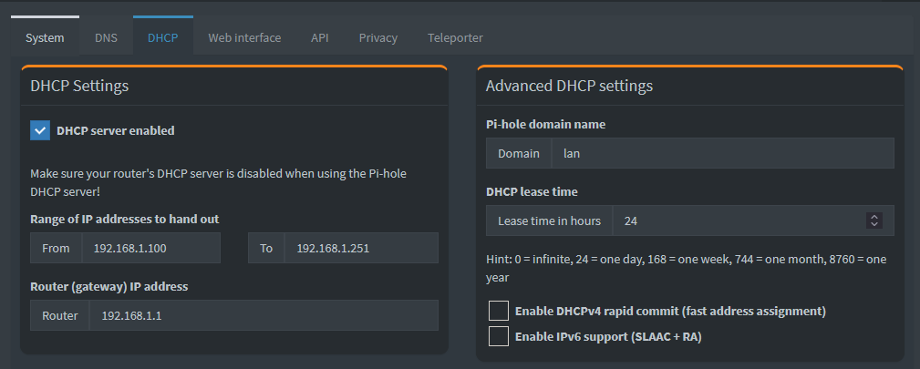

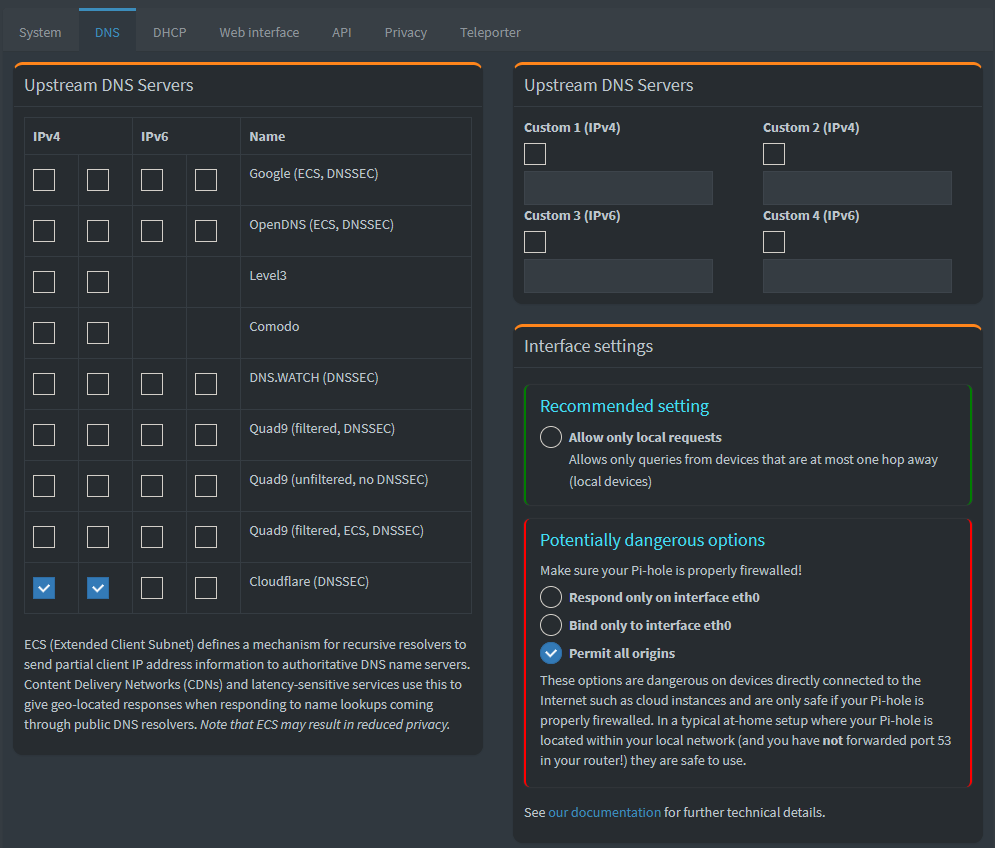

I replaced my ASUS router with a RT-AX86U Pro running Merlin-WRT, replaced my older Raspberry Pi with a Pi 5, fresh install of everything - Pi-Hole running DHCP with DNS set to Cloudflare, OpenDNS, Google, I have tried them all. The issue persists. When I circumvent the Pi-Hole it does not seem to occur. I've tried whitelisting some google domains to alleviate the meet issues, but no luck.

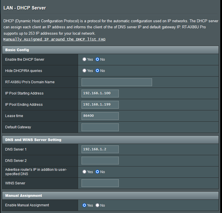

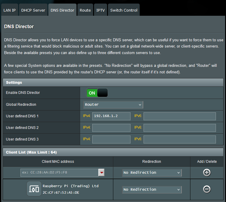

A thought as I have a similar router and setup. Have you tried turning DNS Director off or global redirecting everything to user defined DNS 1 (the Pi) in the dropdown? It's currently set to redirect everything to the router and that may be keeping clients from getting to the Rasperry Pi.
I disabled DNS Director as per bluzfanmr1

This would suggest an issue with upstream DNS servers providing replies not as fast as usually.
Pi-hole wouldn't be involved, as it just waits for the replies to arrive.
You could try to switch to a different set of upstreams and see if the issue persists.
