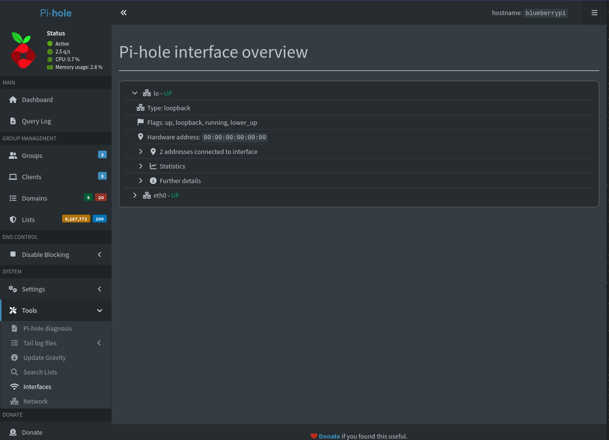

Interfaces Tab only shows eth0 and lo Interfaces
The Interfaces Tab (Tools/Interfaces) in the Web Interface only shows eth0 and lo, although
wlan0, wlan1 and wg0 are also available. wlan1 and wg0 are connected and devices from wg0 are sending queries to Pi-hole. The setting dns.interface is set to wg0.
DHCP is disabled.
I am wondering if this is intentional before submitting a bug report.

The page should show all interfaces. Look at the screenshots here:
We will take a look in your debug log to try to understand what is happening in your case.

Please check if /var/log/pihole/FTL.log contains any errors when you open the interfaces page.
Opening up the Interfaces tab will not result in entries(neither errors not normal entries) in both FTL.log and webserver.log.

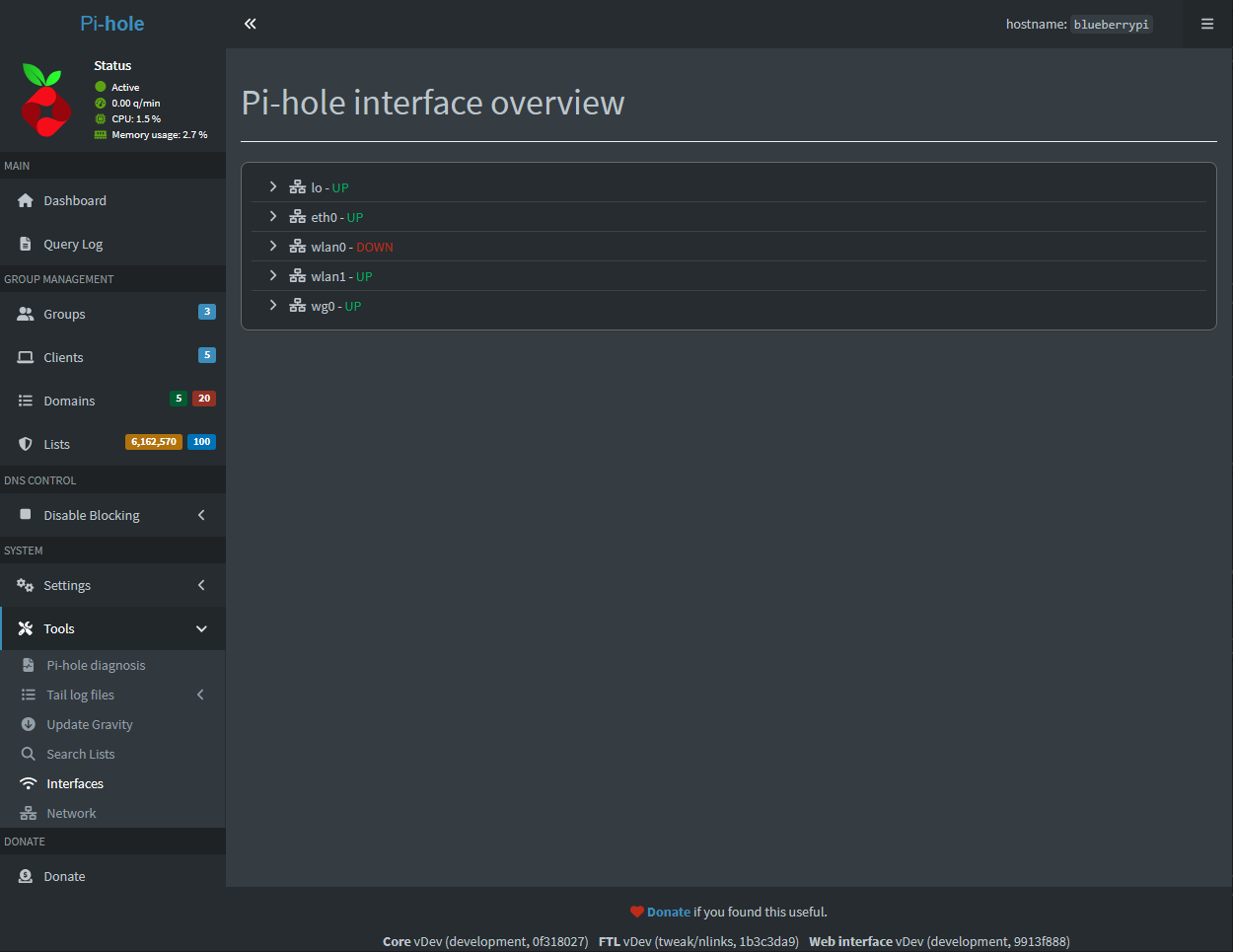

Now when selecting the Interfaces tab I get the output of:
2025-01-25 13:26:16.914 INFO called nlroutes
2025-01-25 13:26:16.914 INFO nlrequest
2025-01-25 13:26:16.914 INFO nlgetmsg
2025-01-25 13:26:16.914 INFO parse_nl_msg(856)
2025-01-25 13:26:16.914 INFO parse route
2025-01-25 13:26:16.914 INFO parse_nl_msg(2592)
2025-01-25 13:26:16.914 INFO parse_nl_msg(20)
2025-01-25 13:26:16.914 INFO called nllinks
2025-01-25 13:26:16.914 INFO parse_nl_msg(4096)
2025-01-25 13:26:16.914 INFO parse link
2025-01-25 13:26:16.914 INFO Parsing link 1 -> lo
2025-01-25 13:26:16.915 INFO parse link
2025-01-25 13:26:16.915 INFO Parsing link 2 -> eth0
2025-01-25 13:26:16.915 INFO nlgetmsg
2025-01-25 13:26:16.915 INFO parse_nl_msg(20)
2025-01-25 13:26:16.915 INFO called nladdrs
2025-01-25 13:26:16.915 INFO nlrequest
2025-01-25 13:26:16.915 INFO parse_nl_msg(328)
2025-01-25 13:26:16.915 INFO parse addr
2025-01-25 13:26:16.915 INFO Parsing address 1 of lo
2025-01-25 13:26:16.915 INFO Parsing address 2 of eth0
2025-01-25 13:26:16.915 INFO Parsing address 4 of wlan1
2025-01-25 13:26:16.915 INFO Parsing address 5 of wg0
2025-01-25 13:26:16.915 INFO parse_nl_msg(576)

In the intermediary patch or what i installed the output was:
2025-01-25 19:06:28.981 WARNING Netlink: Interface wlan1 undefined
2025-01-25 19:06:28.981 WARNING Netlink: Interface wg0 undefined
It seems like your kernel is maxing out the buffer in the first round, causing some interface information to be cropped. When we go and try to get the rest of it, we only get some debris which cannot be parsed. This is very different that what my kernel replies with, which kernel do you run? For me, it is
$ uname -a
Linux ryzen 6.8.0-51-generic #52-Ubuntu SMP PREEMPT_DYNAMIC Thu Dec  5 13:09:44 UTC 2024 x86_64 x86_64 x86_64 GNU/Linux
Please try again with the most recent commit 1b3c3da9 which tries to maybe remedy/circumvent this by doubling the allowed buffer size from 4kB to 8kB.
uname -a outputs
Linux blueberrypi 6.6.74-v8-16k+ #1842 SMP PREEMPT Fri Jan 24 16:20:20 GMT 2025 aarch64 GNU/Linux
I am running the normal Raspbian which uses 6.6.z LTS kernel.
I regularly run sudo rpi-update so i am using the latest dev 6.6.z kernel.
Updating take some minutes due to it refreshing my 100 gravity lists.

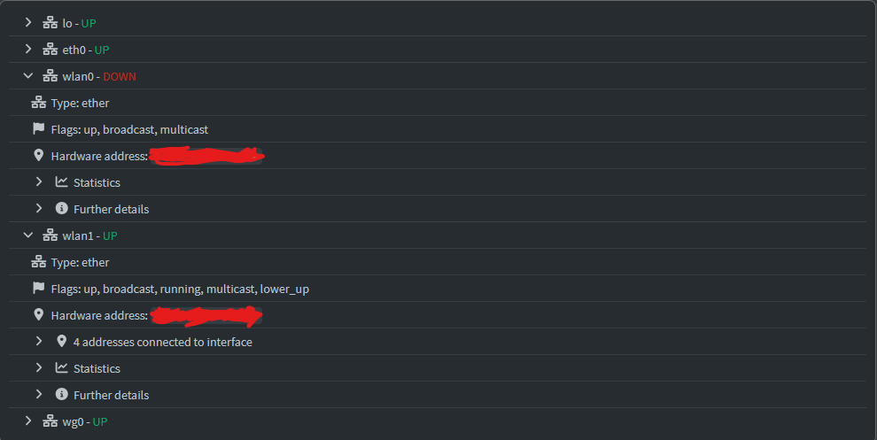

This update fixed the issue and all interfaces now show up.
But still, here is the current output:

2025-01-25 19:30:51.419 DEBUG_NETLINK parsing route
2025-01-25 19:30:51.419 DEBUG_NETLINK Parsing IPv4 route: table 254 is 192.168.178.0 via direct
2025-01-25 19:30:51.419 DEBUG_NETLINK Parsing Netlink message (type 24, len 68/548, flags 0x2, sqe 0)
2025-01-25 19:30:51.419 DEBUG_NETLINK Parsing IPv4 route: table 254 is 192.168.179.0 via direct
2025-01-25 19:30:51.419 DEBUG_NETLINK Parsing Netlink message (type 24, len 60/480, flags 0x2, sqe 0)
2025-01-25 19:30:51.419 DEBUG_NETLINK Parsing IPv4 route: table 255 is 127.0.0.0 via direct
2025-01-25 19:30:51.419 DEBUG_NETLINK Parsing Netlink message (type 24, len 60/420, flags 0x2, sqe 0)
2025-01-25 19:30:51.419 DEBUG_NETLINK Parsing IPv4 route: table 255 is 127.0.0.1 via direct
2025-01-25 19:30:51.419 DEBUG_NETLINK Parsing Netlink message (type 24, len 60/360, flags 0x2, sqe 0)
2025-01-25 19:30:51.419 DEBUG_NETLINK Parsing IPv4 route: table 255 is 127.255.255.255 via direct
2025-01-25 19:30:51.420 DEBUG_NETLINK Parsing Netlink message (type 24, len 60/300, flags 0x2, sqe 0)
2025-01-25 19:30:51.420 DEBUG_NETLINK parsing route
2025-01-25 19:30:51.420 DEBUG_NETLINK Parsing IPv4 route: table 255 is 172.29.0.1 via direct
2025-01-25 19:30:51.420 DEBUG_NETLINK Parsing Netlink message (type 24, len 60/240, flags 0x2, sqe 0)
2025-01-25 19:30:51.420 DEBUG_NETLINK Parsing IPv4 route: table 255 is 192.168.178.158 via direct
2025-01-25 19:30:51.420 DEBUG_NETLINK Parsing Netlink message (type 24, len 60/180, flags 0x2, sqe 0)
2025-01-25 19:30:51.420 DEBUG_NETLINK Parsing IPv4 route: table 255 is 192.168.178.255 via direct
2025-01-25 19:30:51.420 DEBUG_NETLINK Parsing Netlink message (type 24, len 60/120, flags 0x2, sqe 0)
2025-01-25 19:30:51.420 DEBUG_NETLINK Parsing IPv4 route: table 255 is 192.168.179.6 via direct
2025-01-25 19:30:51.420 DEBUG_NETLINK Parsing Netlink message (type 24, len 60/60, flags 0x2, sqe 0)
2025-01-25 19:30:51.420 DEBUG_NETLINK Parsing IPv4 route: table 255 is 192.168.179.255 via direct
2025-01-25 19:30:51.420 DEBUG_NETLINK Next nl_msg_type: 0
2025-01-25 19:30:51.420 DEBUG_NETLINK Calling nlgetmsg
2025-01-25 19:30:51.420 DEBUG_NETLINK Calling parse_nl_msg (2980)
2025-01-25 19:30:51.420 DEBUG_NETLINK Parsing Netlink message (type 24, len 116/2980, flags 0x2, sqe 0)
2025-01-25 19:30:51.420 DEBUG_NETLINK Parsing IPv6 route: table 254 is 2001:9e8:b3ef:2000:: via direct
2025-01-25 19:30:51.420 DEBUG_NETLINK Parsing Netlink message (type 24, len 116/2864, flags 0x2, sqe 0)
2025-01-25 19:30:51.420 DEBUG_NETLINK Parsing IPv6 route: table 254 is 2001:9e8:b3ef:2001:: via direct
2025-01-25 19:30:51.420 DEBUG_NETLINK Parsing Netlink message (type 24, len 136/2748, flags 0x2, sqe 0)
2025-01-25 19:30:51.420 DEBUG_NETLINK Parsing Netlink message (type 24, len 136/2612, flags 0x2, sqe 0)
2025-01-25 19:30:51.420 DEBUG_NETLINK Parsing Netlink message (type 24, len 116/2476, flags 0x2, sqe 0)
2025-01-25 19:30:51.420 DEBUG_NETLINK Parsing IPv6 route: table 254 is fd00:abcd:4567:1:: via direct
2025-01-25 19:30:51.420 DEBUG_NETLINK Parsing Netlink message (type 24, len 116/2360, flags 0x2, sqe 0)
2025-01-25 19:30:51.420 DEBUG_NETLINK Parsing IPv6 route: table 254 is fde6:4eec:57f7:: via direct
2025-01-25 19:30:51.420 DEBUG_NETLINK Parsing Netlink message (type 24, len 136/2244, flags 0x2, sqe 0)
2025-01-25 19:30:51.420 DEBUG_NETLINK Parsing Netlink message (type 24, len 116/2108, flags 0x2, sqe 0)
2025-01-25 19:30:51.420 DEBUG_NETLINK Parsing IPv6 route: table 254 is fde6:4eec:57f7:1:: via direct
2025-01-25 19:30:51.420 DEBUG_NETLINK Parsing Netlink message (type 24, len 136/1992, flags 0x2, sqe 0)
2025-01-25 19:30:51.420 DEBUG_NETLINK Parsing Netlink message (type 24, len 116/1856, flags 0x2, sqe 0)
2025-01-25 19:30:51.420 DEBUG_NETLINK Parsing IPv6 route: table 254 is fe80:: via direct
2025-01-25 19:30:51.420 DEBUG_NETLINK Parsing Netlink message (type 24, len 116/1740, flags 0x2, sqe 0)
2025-01-25 19:30:51.420 DEBUG_NETLINK Parsing Netlink message (type 24, len 116/1624, flags 0x2, sqe 0)
2025-01-25 19:30:51.420 DEBUG_NETLINK Parsing IPv6 route: table 254 is default via direct
2025-01-25 19:30:51.420 DEBUG_NETLINK Parsing Netlink message (type 24, len 116/1508, flags 0x2, sqe 0)
2025-01-25 19:30:51.420 DEBUG_NETLINK Parsing Netlink message (type 24, len 116/1392, flags 0x2, sqe 0)
2025-01-25 19:30:51.420 DEBUG_NETLINK Parsing IPv6 route: table 255 is ::1 via direct
2025-01-25 19:30:51.420 DEBUG_NETLINK Parsing Netlink message (type 24, len 116/1276, flags 0x2, sqe 0)
2025-01-25 19:30:51.420 DEBUG_NETLINK Parsing IPv6 route: table 255 is 2001:9e8:b3ef:2000:c4:bb4e:cf36:dbeb via direct
2025-01-25 19:30:51.420 DEBUG_NETLINK Parsing Netlink message (type 24, len 116/1160, flags 0x2, sqe 0)
2025-01-25 19:30:51.420 DEBUG_NETLINK Parsing IPv6 route: table 255 is 2001:9e8:b3ef:2001:a918:a49e:3a79:ec7e via direct
2025-01-25 19:30:51.420 DEBUG_NETLINK Parsing Netlink message (type 24, len 116/1044, flags 0x2, sqe 0)
2025-01-25 19:30:51.420 DEBUG_NETLINK Parsing IPv6 route: table 255 is fd00:abcd:4567:1:: via direct
2025-01-25 19:30:51.420 DEBUG_NETLINK Parsing Netlink message (type 24, len 116/928, flags 0x2, sqe 0)
2025-01-25 19:30:51.420 DEBUG_NETLINK Parsing IPv6 route: table 255 is fd00:abcd:4567:1::1 via direct
2025-01-25 19:30:51.420 DEBUG_NETLINK Parsing Netlink message (type 24, len 116/812, flags 0x2, sqe 0)
2025-01-25 19:30:51.420 DEBUG_NETLINK Parsing IPv6 route: table 255 is fde6:4eec:57f7:0:51d7:eb29:e44:13d8 via direct
2025-01-25 19:30:51.420 DEBUG_NETLINK Parsing Netlink message (type 24, len 116/696, flags 0x2, sqe 0)
2025-01-25 19:30:51.420 DEBUG_NETLINK Parsing IPv6 route: table 255 is fde6:4eec:57f7:1:d625:71c4:fe4b:3b3e via direct
2025-01-25 19:30:51.420 DEBUG_NETLINK Parsing Netlink message (type 24, len 116/580, flags 0x2, sqe 0)
2025-01-25 19:30:51.420 DEBUG_NETLINK Parsing IPv6 route: table 255 is fe80::c414:a21d:477e:8fb6 via direct
2025-01-25 19:30:51.420 DEBUG_NETLINK Parsing Netlink message (type 24, len 116/464, flags 0x2, sqe 0)
2025-01-25 19:30:51.420 DEBUG_NETLINK Parsing IPv6 route: table 255 is fe80::ecd0:451b:792b:f8eb via direct
2025-01-25 19:30:51.420 DEBUG_NETLINK Parsing Netlink message (type 24, len 116/348, flags 0x2, sqe 0)
2025-01-25 19:30:51.420 DEBUG_NETLINK Parsing IPv6 route: table 255 is ff00:: via direct
2025-01-25 19:30:51.420 DEBUG_NETLINK Parsing Netlink message (type 24, len 116/232, flags 0x2, sqe 0)
2025-01-25 19:30:51.420 DEBUG_NETLINK Parsing Netlink message (type 24, len 116/116, flags 0x2, sqe 0)
2025-01-25 19:30:51.420 DEBUG_NETLINK Calling parse_nl_msg (20)
2025-01-25 19:30:51.420 DEBUG_NETLINK Next nl_msg_type: 3
2025-01-25 19:30:51.420 DEBUG_NETLINK Called nllinks
2025-01-25 19:30:51.420 DEBUG_NETLINK nlrequest
2025-01-25 19:30:51.421 DEBUG_NETLINK Calling nlgetmsg
2025-01-25 19:30:51.421 DEBUG_NETLINK Calling parse_nl_msg (7280)
2025-01-25 19:30:51.421 DEBUG_NETLINK Parsing Netlink message (type 16, len 1428/7280, flags 0x2, sqe 0)
2025-01-25 19:30:51.421 DEBUG_NETLINK parsing link
2025-01-25 19:30:51.421 DEBUG_NETLINK Parsing unspec link 1 -> lo
2025-01-25 19:30:51.421 DEBUG_NETLINK Parsing Netlink message (type 16, len 1488/5852, flags 0x2, sqe 0)
2025-01-25 19:30:51.421 DEBUG_NETLINK Parsing unspec link 2 -> eth0
2025-01-25 19:30:51.421 DEBUG_NETLINK Parsing Netlink message (type 16, len 1476/4364, flags 0x2, sqe 0)
2025-01-25 19:30:51.421 DEBUG_NETLINK Parsing unspec link 3 -> wlan0
2025-01-25 19:30:51.421 DEBUG_NETLINK Parsing Netlink message (type 16, len 1464/2888, flags 0x2, sqe 0)
2025-01-25 19:30:51.421 DEBUG_NETLINK Parsing unspec link 4 -> wlan1
2025-01-25 19:30:51.421 DEBUG_NETLINK Parsing Netlink message (type 16, len 1424/1424, flags 0x2, sqe 0)
2025-01-25 19:30:51.421 DEBUG_NETLINK Parsing unspec link 5 -> wg0
2025-01-25 19:30:51.421 DEBUG_NETLINK Next nl_msg_type: 0
2025-01-25 19:30:51.421 DEBUG_NETLINK Calling parse_nl_msg (20)
2025-01-25 19:30:51.421 DEBUG_NETLINK Next nl_msg_type: 3
2025-01-25 19:30:51.421 DEBUG_NETLINK Called nladdrs
2025-01-25 19:30:51.421 DEBUG_NETLINK nlrequest
2025-01-25 19:30:51.421 DEBUG_NETLINK Calling parse_nl_msg (328)
2025-01-25 19:30:51.421 DEBUG_NETLINK Parsing Netlink message (type 20, len 76/328, flags 0x2, sqe 0)
2025-01-25 19:30:51.421 DEBUG_NETLINK parsing address
2025-01-25 19:30:51.421 DEBUG_NETLINK Parsing inet address of iface lo (1): 127.0.0.1/8
2025-01-25 19:30:51.421 DEBUG_NETLINK Parsing Netlink message (type 20, len 88/252, flags 0x2, sqe 0)
2025-01-25 19:30:51.421 DEBUG_NETLINK Parsing inet address of iface eth0 (2): 192.168.178.158/24
2025-01-25 19:30:51.421 DEBUG_NETLINK Parsing Netlink message (type 20, len 88/164, flags 0x2, sqe 0)
2025-01-25 19:30:51.421 DEBUG_NETLINK Parsing inet address of iface wlan1 (4): 192.168.179.6/24
2025-01-25 19:30:51.421 DEBUG_NETLINK Parsing Netlink message (type 20, len 76/76, flags 0x2, sqe 0)
2025-01-25 19:30:51.421 DEBUG_NETLINK Parsing inet address of iface wg0 (5): 172.29.0.1/32
2025-01-25 19:30:51.421 DEBUG_NETLINK Calling parse_nl_msg (576)
2025-01-25 19:30:51.421 DEBUG_NETLINK Parsing Netlink message (type 20, len 72/576, flags 0x2, sqe 0)
2025-01-25 19:30:51.421 DEBUG_NETLINK Parsing inet6 address of iface lo (1): ::1/128
2025-01-25 19:30:51.421 DEBUG_NETLINK Parsing Netlink message (type 20, len 72/504, flags 0x2, sqe 0)
2025-01-25 19:30:51.421 DEBUG_NETLINK Parsing inet6 address of iface eth0 (2): 2001:9e8:b3ef:2000:c4:bb4e:cf36:dbeb/64
2025-01-25 19:30:51.421 DEBUG_NETLINK Parsing Netlink message (type 20, len 72/432, flags 0x2, sqe 0)
2025-01-25 19:30:51.421 DEBUG_NETLINK Parsing inet6 address of iface eth0 (2): fde6:4eec:57f7:0:51d7:eb29:e44:13d8/64
2025-01-25 19:30:51.421 DEBUG_NETLINK Parsing Netlink message (type 20, len 72/360, flags 0x2, sqe 0)
2025-01-25 19:30:51.421 DEBUG_NETLINK Parsing inet6 address of iface eth0 (2): fe80::ecd0:451b:792b:f8eb/64
2025-01-25 19:30:51.421 DEBUG_NETLINK Parsing Netlink message (type 20, len 72/288, flags 0x2, sqe 0)
2025-01-25 19:30:51.421 DEBUG_NETLINK Parsing inet6 address of iface wlan1 (4): 2001:9e8:b3ef:2001:a918:a49e:3a79:ec7e/64
2025-01-25 19:30:51.421 DEBUG_NETLINK Parsing Netlink message (type 20, len 72/216, flags 0x2, sqe 0)
2025-01-25 19:30:51.421 DEBUG_NETLINK Parsing inet6 address of iface wlan1 (4): fde6:4eec:57f7:1:d625:71c4:fe4b:3b3e/64
2025-01-25 19:30:51.421 DEBUG_NETLINK Parsing Netlink message (type 20, len 72/144, flags 0x2, sqe 0)
2025-01-25 19:30:51.421 DEBUG_NETLINK Parsing inet6 address of iface wlan1 (4): fe80::c414:a21d:477e:8fb6/64
2025-01-25 19:30:51.421 DEBUG_NETLINK Parsing Netlink message (type 20, len 72/72, flags 0x2, sqe 0)
2025-01-25 19:30:51.421 DEBUG_NETLINK Parsing inet6 address of iface wg0 (5): fd00:abcd:4567:1::1/64

Both my WLAN adapters show up as Type: ether
wlan0 is the built-in and wlan1 is a USB Adapter.
Type: ether is correct even for WiFi interfaces as they are still Ethernet devices in the ARP sense. I will still look at reproducing this locally to analyze the issue (it seems to happen with arm64 sometimes) but I will first need to buy a Raspberry Pi 5 for this.
Raspberry Pi 5 received yesterday and dove deeply into the kernel source code and documentation. The result is
https://github.com/pi-hole/FTL/pull/2168
which should work. Could you please check if the current state of this same branch is still
  1. returning the interfaces are expected, and
  2. NOT showing any Netlink-related warnings
for you?
It'd probably be the easiest if you first turn of debug.netlink to avoid cluttering the log with content.
