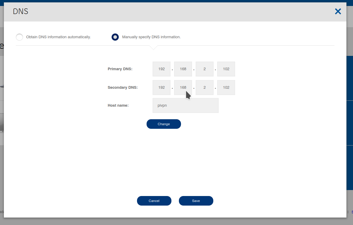

That's the pic from https://pi-hole.net/ main page but that's how I had set up my router.
I currently don't have Pihole on any machines thus the new router is not configured to use Pihole.
Ready to install Pihole when you say so.
@Bucking_Horn My actual router. These settings are NOT ACTIVE but this is what I did originally, with my old router.

I can't know for sure, as every router, model and firmware is different:
On that screenshot, that 'Obtain DNS information automatically' option would suggest that screen is about configuring your router's upstream DNS resolvers.
By pointing your RPi Zero 2 to static domain_name_servers=192.168.2.1
, you'd have prepared the preconditions for a DNS loop for your Zero 2.
If your Pi-hole would be configured to use your router as its upstream, or if you'd had Pi-hole's Conditional Forwarding enabled, then you'd have closed a full or partial DNS loop for all clients in your entire network.
You should investigate your new router's DHCP settings and configure those to distribute solely your Pi-hole host's IP address as local DNS server.
