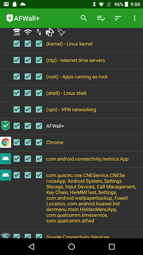

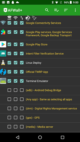

  1. Firewall time. I used AFWall+ https://play.google.com/store/apps/details?id=dev.ukanth.ufirewall to get started. I set it to block by default and punched holes for things until the alert messages stopped happening. Here are screenshots of my AFWall+ settings:
