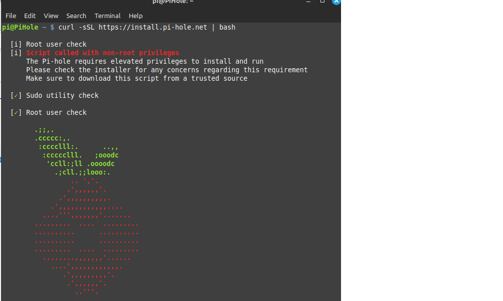

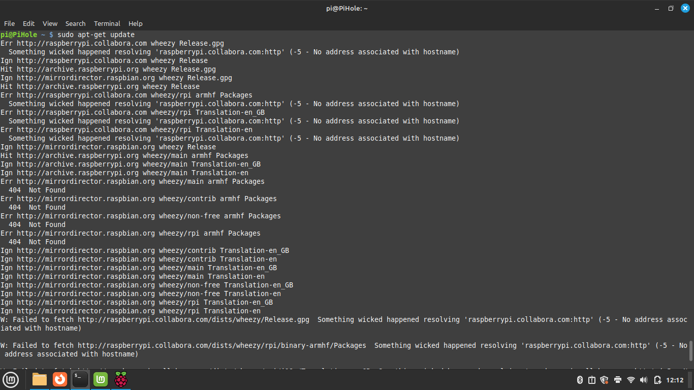

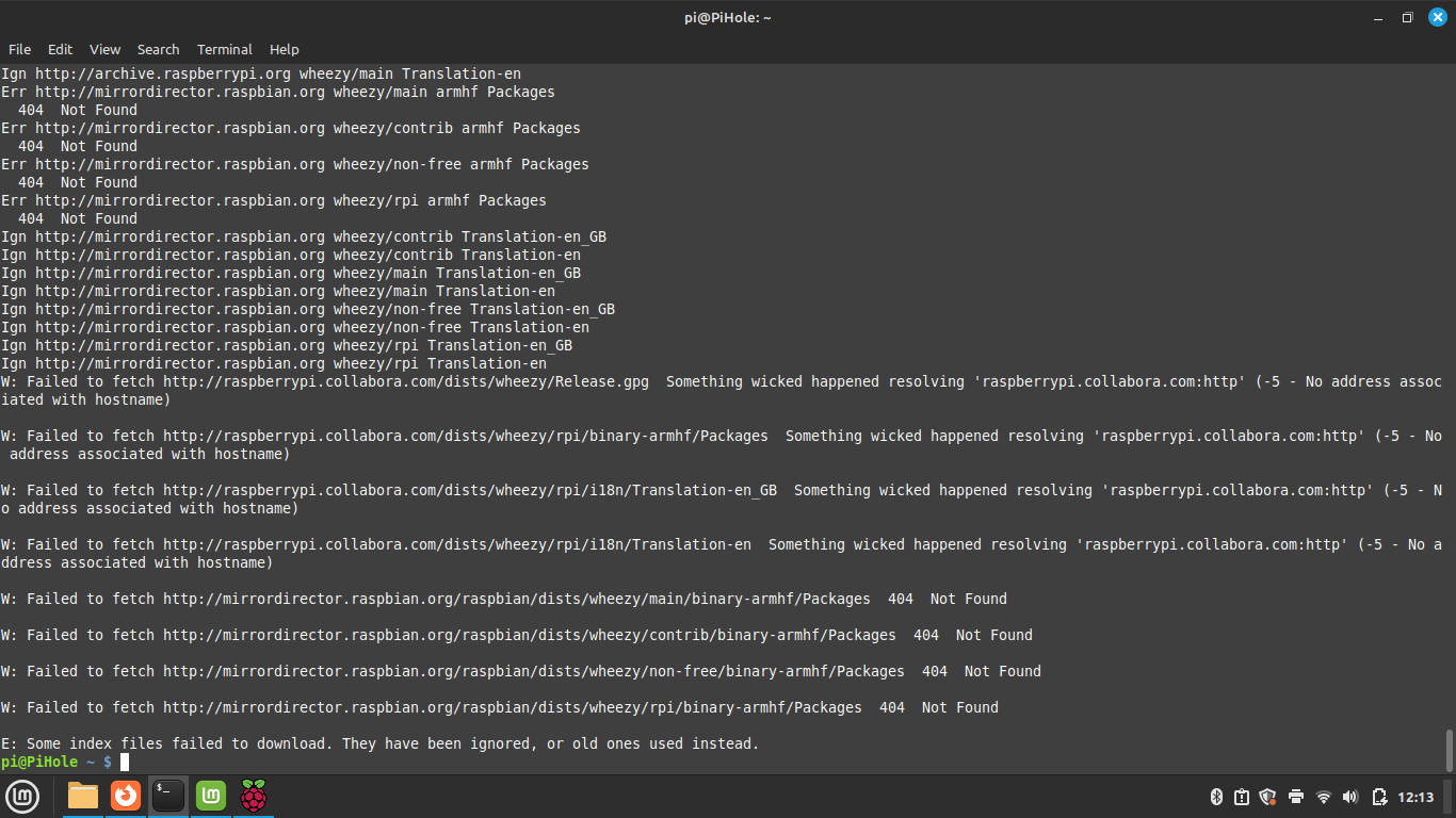

Installer says " Error: Unable to update package cache. Please try "sudo apt-get update" update run and same error
Standard install as far as im aware.
using a 2011 pi1? running a fresh install of rasbian on 16gb sd card
trying to install the software
Getting hung up at the same spot even after running the updates and rebooting.
N/A
Im not sure what to do next, any advice appreciated. Thanks

You are never going to install Pi-hole on Wheezy, regardless of whether you solve this package problem or not.
Our currently supported versions of Raspbian (or now called Raspberry Pi OS) are Buster (10) and Bullseye (11) ; and soon we will support Bookworm (12).
Wheezy (Debian 7) is beyond ancient, and is almost a half decade out of support by Pi-hole and Raspbian.
  • Wheezy becomes oldoldstable (17 June 2017; 6 years ago)
  • Wheezy long term support reached end-of-life (1 June 2018; 5 years ago)
  • Wheezy extended long term support reached end-of-life (30 June 2020; 3 years ago)
Cut your losses now.
