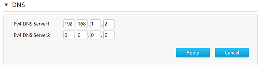

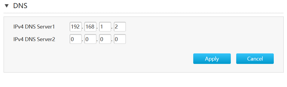

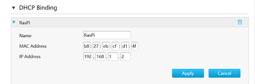

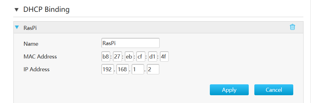

Pi has been assigned a static IP:

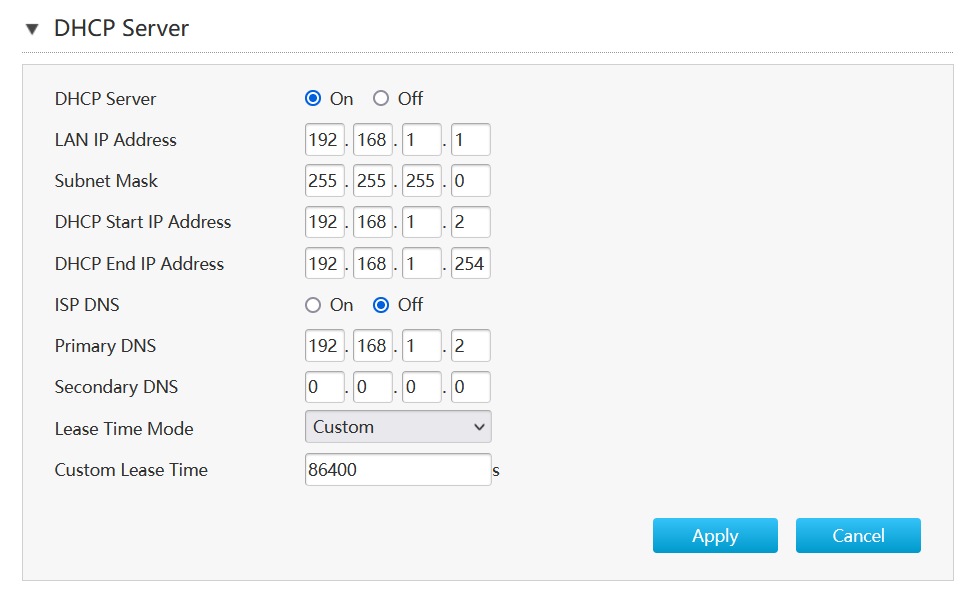

Configuring the Router to use Pi-hole:

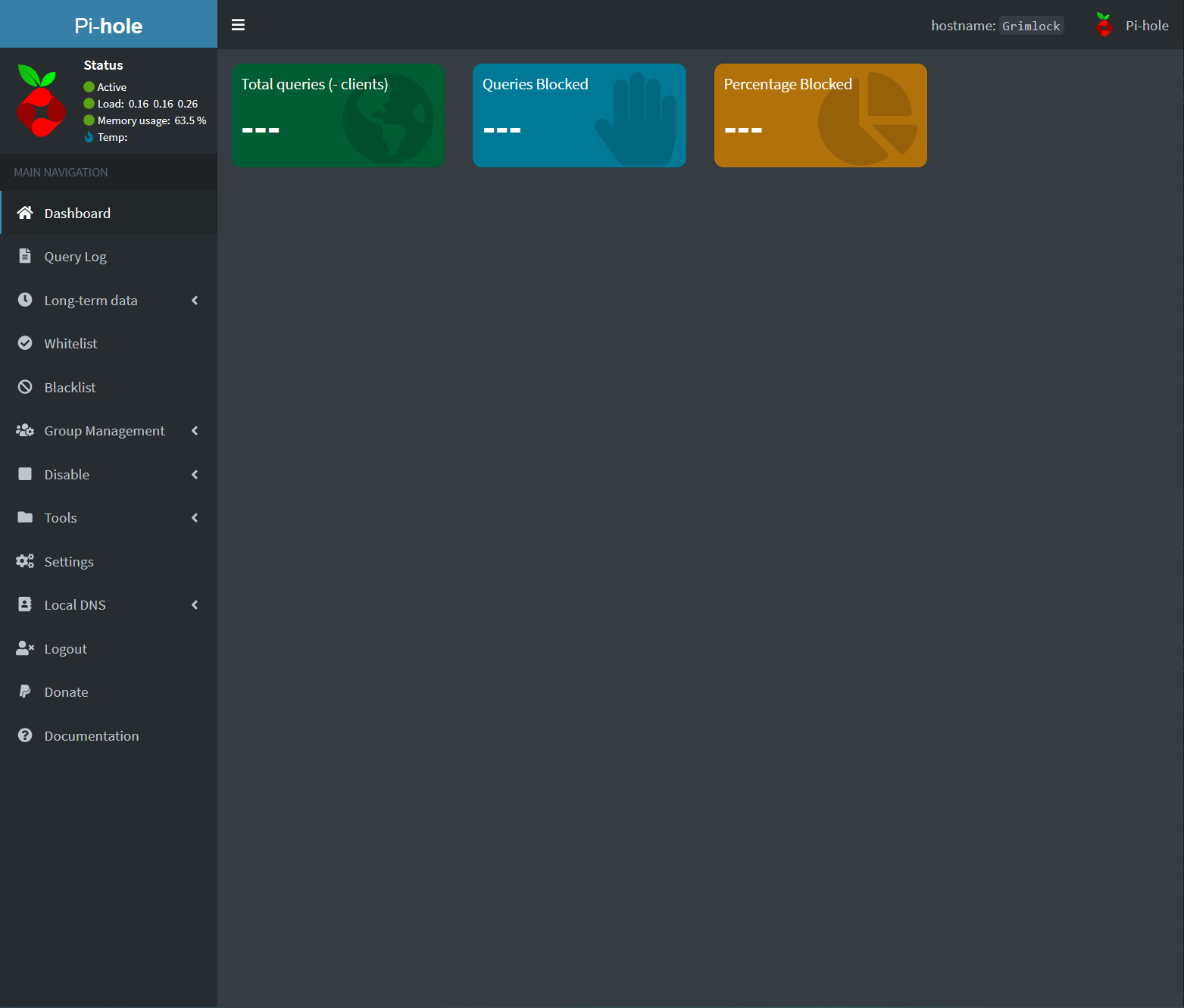

Still, I've got nothing:
What am I missing? Are there settings I'm yet to configure?

Your telnet API stats results demonstrate that your Pi-hole is receiving, filtering and forwarding queries. Those numbers would also be reflected in Pi-hole's UI, suggesting that this is indeed a display issue, likely due to nginx.
A common cause for issues with nginx would be wrong or missing permissions, e.g. due to group memberships. Please reverify that you've applied the respective steps from the nginx user guide
Huh, that's weird, I went back & fiddled with the syntax, permissions & instructions a bit more. No dice.

Though one more thing of note,
attempting to access Settings > Group Management > Groups
I'm hit with:
DataTables warning: table id=groupsTable - Ajax error. For more information about this error, please see http://datatables.net/tn/7
Same goes for Tools > Pi-Hole disgnosis
And Tools > Network gives:
An unknown error occurred while loading the data.
Finally Long-term data > Query Log returns:
Check the server's log files (/var/log/lighttpd/error.log) for details.
You may need to increase PHP memory limit.
You can find more info in pi-hole's FAQ:
https://docs.pi-hole.net/main/faq/#error-while-loading-data-from-the-long-term-database
I should hope the 512M I've allocated should be enough,
Since I don't have lighttpd logs, I checked nginx & sure enough, they were filled with:
Stack trace:
#0 /var/www/html/admin/api_db.php(26): SQLite3_connect()
#1 {main}
  thrown in /var/www/html/admin/scripts/pi-hole/php/database.php on line 61" while reading response header from upstream, client: 192.168.1.6, server: XXXX, request: "GET /admin/api_db.php?status HTTP/1.1", upstream: "fastcgi://unix:/run/php/php8.0-fpm.sock:", host: "19>2022/03/16 00:17:08 [error] 30238#30238: *296 FastCGI sent in stderr: "PHP message: PHP Fatal error:  Uncaught Error: Undefined constant "SQLITE3_OPEN_READONLY" in /var/www/html/admin/scripts/pi-hole/php/database.php:61
That was eye-opening, & this forum post led me to install php8.0-sqlite3 which ended up fixing the whole problem :sweat_smile:
