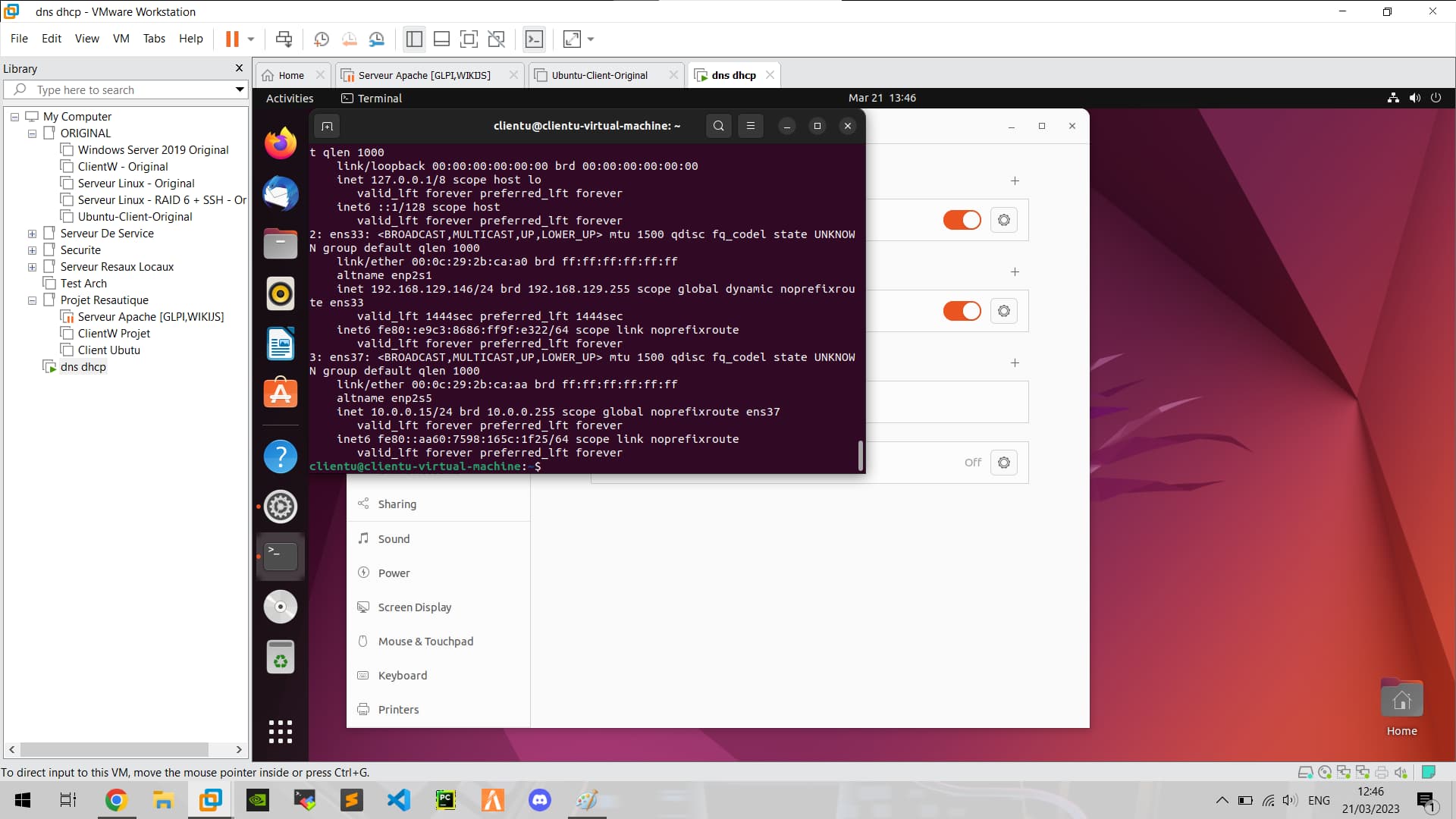

I want to install Pi-hole on my ex: ens37 ethernet interface . It should be on my ex:10.0.0.15 address
When its time to select the interface even if there is the little start beside (*) the ens37 it install it with on the ens33 with an ip of 192.168.2.4 and give me the admin page on the other interface . but it even say that is installed on interface ens37 but with the ip address of ens33
I tried it like 4-5 time dunno whats seems to be the problem

AH never mind it worked , just because in the script the address showed for login page was 192.168.129.146 as it was like ens33 but when i typed the address of the ens37 interface it worked. lol
Your debug log shows ens37 is being used:
    PIHOLE_INTERFACE=ens37
[✓] IPv4 address(es) bound to the ens37 interface:
    10.0.0.15/24
