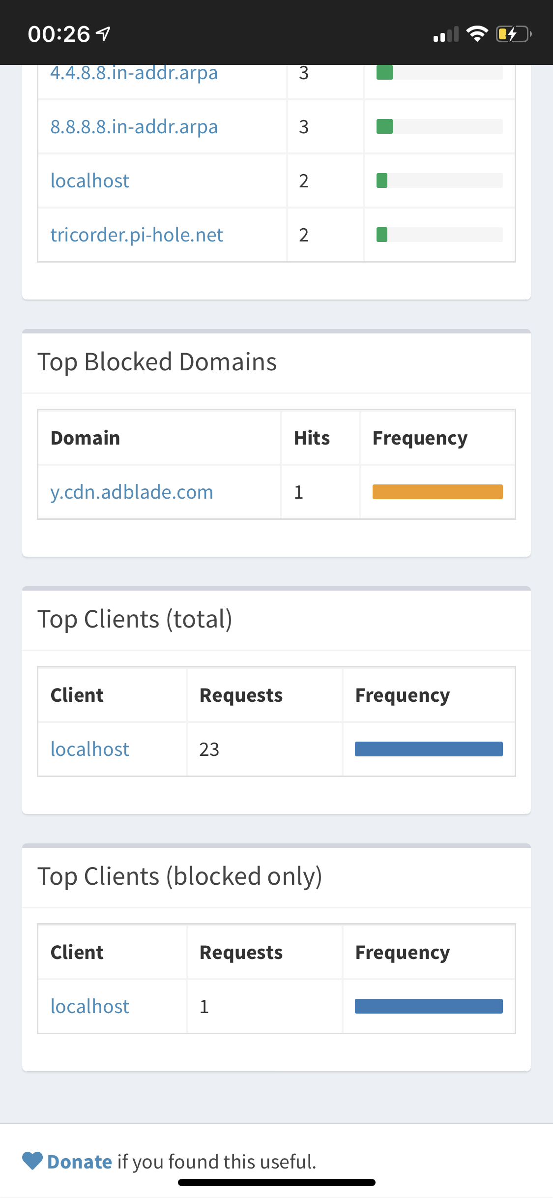

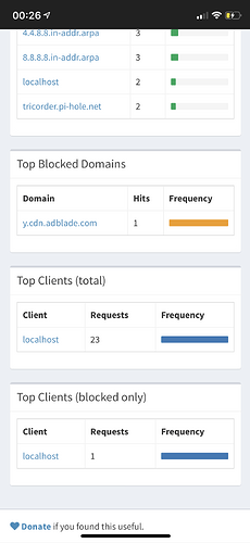

What I noticed is that this time, into the dashboard, PiHole isn’t detecting the second client (the router).
What can I do?
