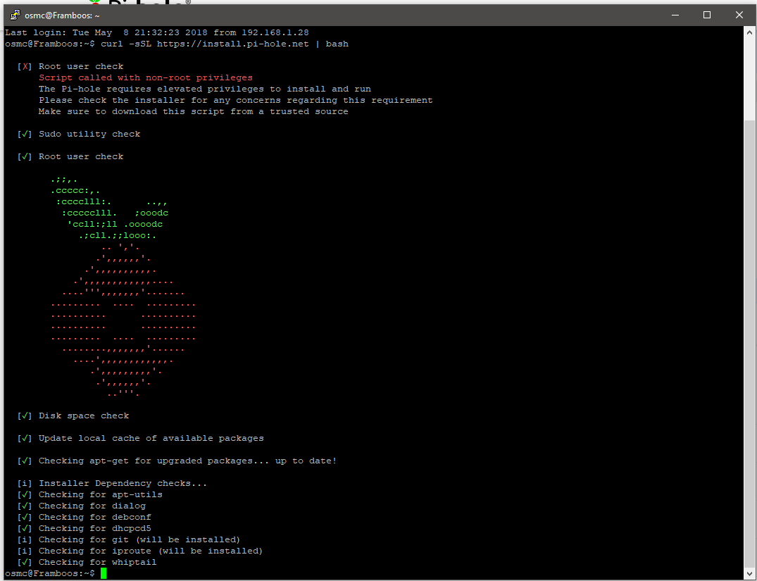

Install stops after 2seconds of showing blue progress bar screen
Easy peasy fresh install of pihole.
unistall pihole > reboot > install pihole > happy me
Uninstalled Pihole > reboot > install pihole > nope.
Tried running the install with "curl -sSL https://install.pi-hole.net | bash" and it just stops after showing the first blue screen with progress bar for only 2 seconds and then sends me back to the command line.

Run sudo apt install iproute2 and sudo apt install git then run the pi-hole install command again.
I think when you removed it, you deleted some dependencies (git and iproute2) that might have been needed by the system too and that messed up some things.
The installer script calls git as part of the install process.

After trying to "sudo apt install iproute2" it told me
Unmet dependencies. Try 'apt-get -f install' with no packages (or specify a solution).
after doing that iproute2 installed and it said git was already the latest version.
Looks like the install went fine, thank you!
