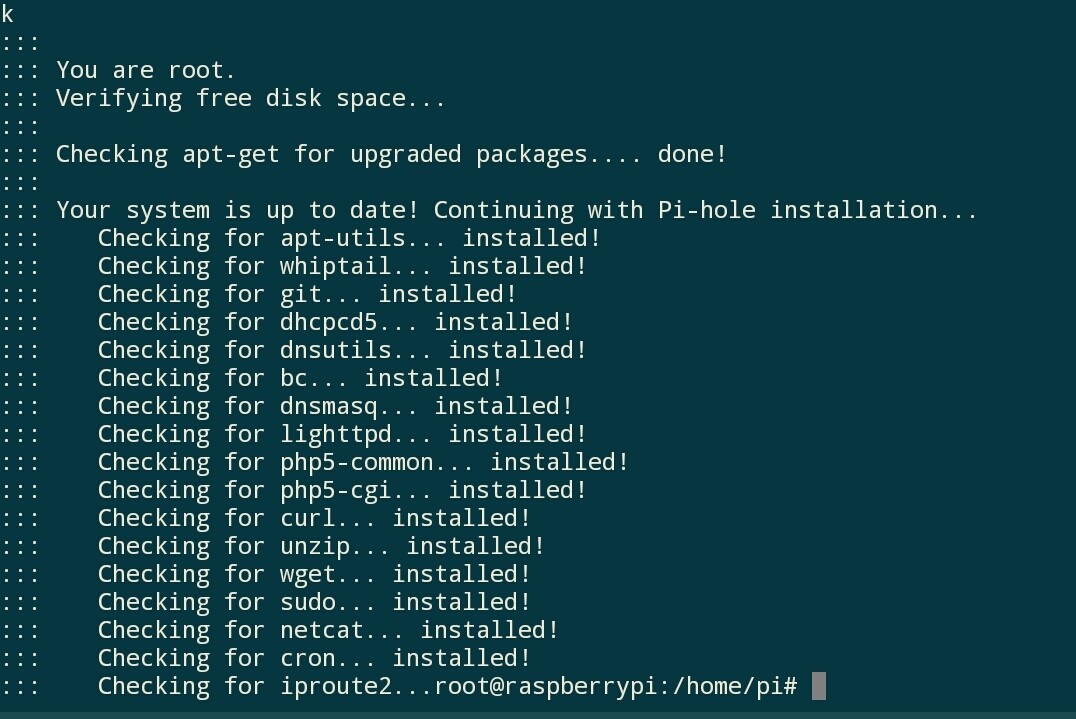

I am having the same exact problem except it stops while checking for iproute2. I have tried installing the package manually but it is already installed. I removed the package and reinstalled it but that still didn't fix the problem. Is there anything else that could be causing the script to stop while checking the dependencies?
Can you paste a copy of the terminal output when the script stops running? The iproute2 package is different depending on the distribution version.
I tried reinstalling Raspbian but I'm still having the same problem.
