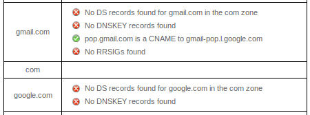

Having said that, I just put pop.gmail.com
into the DNSSEC validator and found out that they don't have it set up properly! If you have more specific domains, I'd be happy to analyze them with you as well.

Yes it replies as secure. Now what? I guess that means dnssec is working on my end and the reason places like google and microsft show insecure is because they haven't tweaked their settings?
