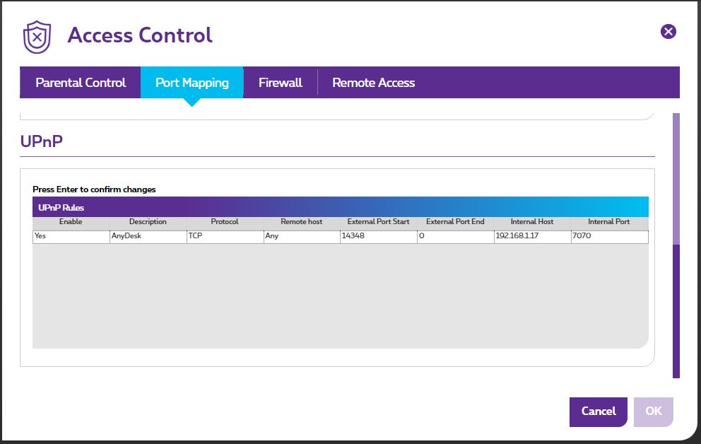

The issue I am facing:
My ISP obligates me to use a router with hardcoded DNS. I want to use another DNS server so I installed Pi-Hole and use it as DHCP server so that it provides to all my devices the preferred DNS server. (I have disabled the DHCP on my router.) The router still is my default gateway. On this router there is an UPnP port mapping set for AnyDesk (please see screenshot attached).
My question is: Will the default settings of Pi-hole block the incomming or outgoing connections to / from AnyDesk ?
If yes, what changes do I need to make to Pi-hole in order to be able to use AnyDesk without any problem ?
I've been reading a lot of related posts on the web (like this one), but it still isn't clear to me whether I need to white list AnyDesk or open any extra ports or do something else.

Influence of Pi-hole on UPnP Portmapping?
None.
Certainly not any incoming traffic.
As far as connections to public servers via domain names are concerned: I cannot answer that, as I do not know AnyDesk, and additionally, I cannot know what blocklists you have decided to use.
My answer in that post applies.
Pi-hole is a filtering DNS forwarder - it isn't concerned with ports, so it wouldn't interfere with any of your router's port mappings.
It may, however, interfere with AnyDesk if any of the domains that AnyDesk would ask resolution for would be on one of the blocklists you've configured for your Pi-hole, and blockage of that domain would prevent AnyDesk to operate as expected.
How do I determine what domain an ad is coming from? may help in finding out about relevant domains.
As detailed in Pi-hole's documentation, port 4711 is meant to be accessible via the loopback interface exclusively. It shouldn't be opened for outside access.

If necessary, watch Pi-hole's Query Log for blocked entries originating from the client that runs AnyDesk (preferably when nothing else is running) and whitelist domains associated with AnyDesk.
Try and run AnyDesk first.
If everything works as expected, there'd be no need for additional blocklist handling in Pi-hole.
Thanks for this reply. I have checked the output of the Query Log for the client that runs AnyDesk and could only find "OK (cached)" and "OK (forwarded to dns.google#53)". It looks like pi-hole isn't interfering with AnyDesk.
I'll keep monitoring it, but at first sight everything is looking good.
