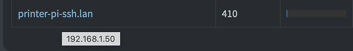

I've a cosmetic Issue with my pihole installation. It seems that client hostnames are cached somewhere and are not updated.
Is there a way to clear this cache?
Local Hostnames are frequently updated / cached old hostnames are deleted after e.g. 12 hrs.
Old hostnames are cached somewhere and aren't updated:
The cached hostname doesn't exist anymore:

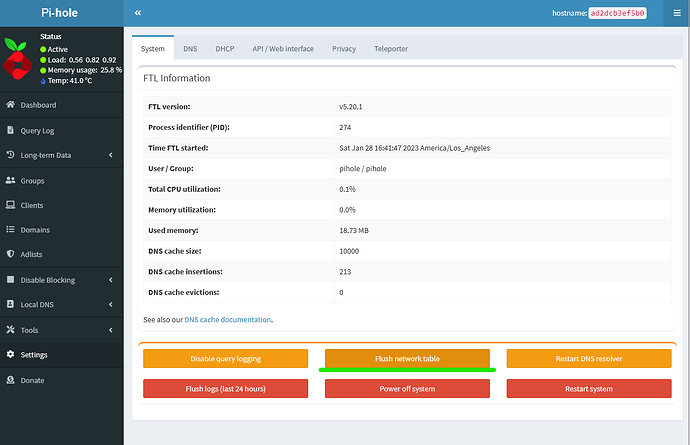

Try Flush Network Table from the settings page on the web admin site.
http://pi.hole/admin/settings.php
Already tried that as well and it didn’t work.
Where are you seeing these stale client names?
The screenshot looks like it came from the index page Top Clients. If that is the case then those are the entries of the name of the host at the time the query was made. They do not dynamically update.

I've had this same problem this evening. After booting this Mac on a Linux Mint live CD for a couple of hours, once I was back on macOS Pi-hole insisted that my hostname was still mint.lan for queries that were being generated right now. I had the same IP for both sessions since it's the same wired network adapater. Pi-hole is the DHCP.
I tried deleting it from the Network view and it came right back as mint.lan. I also tried the Flush network table option you listed and it made no difference.
I then took the nuclear option and rebooted the Pi-hole and that did fix it. Interestingly the Long-term data showed recent queries as mint.lan and then changing to the Mac hostname after the relevant PTR request from localhost (the Pi-hole) for the Mac's reverse IP.
