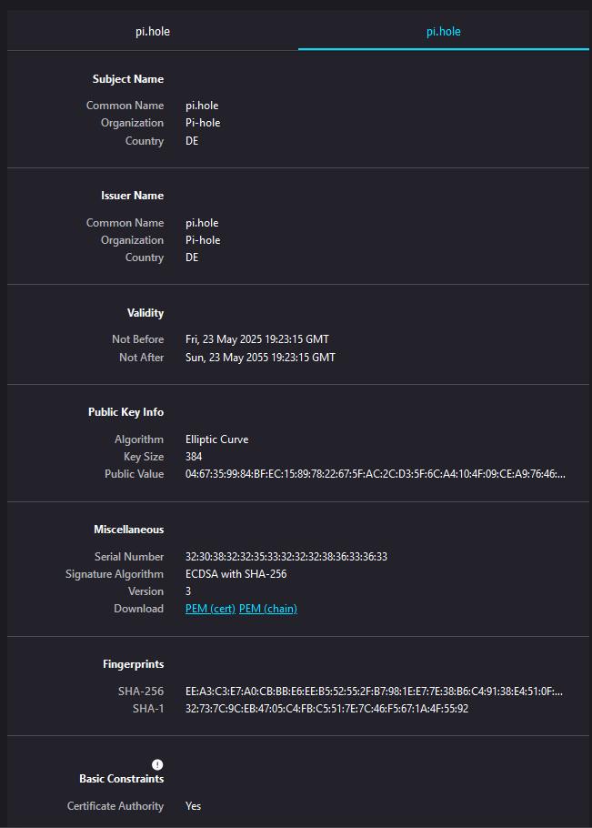

I see. My apologies, it does seem there are two certificates that pi-hole uses, which would indicate a Certification Authority.
root@****:/etc/pihole# openssl verify tls.crt
CN = pi.hole
error 20 at 0 depth lookup: unable to get local issuer certificate
error tls.crt: verification failed`
root@*****:/etc/pihole# openssl verify tls_ca.crt
CN = pi.hole, O = Pi-hole, C = DE
error 18 at 0 depth lookup: self-signed certificate
error tls_ca.crt: verification failed
Failing validation for the CA certificate is normal since it's self-signed. The problem I believe @Meierschlumpf is referring to is this: error 20 at 0 depth lookup: unable to get local issuer certificate when trying to validate the self-signed certificate. Essentially there is no way to obtain the Certification Authority's certificate to validate the chain.

@DL6ER I've just tested, all you'd have to do is append the CA cert to the tls.pem file
root@****:/etc/pihole# cat tls_ca.crt >> tls.pem
