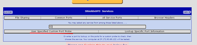

Check a port scan tool for an open port 53. GRC | ShieldsUP! — Internet Vulnerability Profiling   using the custom port 53.

Try the GRC scan mentioned by Dan. That's coming from an external network and so all it can see is whatever is exposed at the IP address. That's typically your home router and has firewalling enabled and configured to prevent unsolicited incoming connections.
That's what I meant earlier. Testing from inside the network with nmap doesn't really produce a meaningful result in the context of testing if the dns is an open resolver because port 53 will of course be shown as open.
I already ran GRC and everything is fine :slight_smile:

But in the end a remote check like ShieldsUP will show what ports are seen as open from the internet at large.
