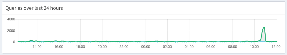

Reviving this as I saw a sharp spike in request on my network about an hour ago:
Here is a sample:

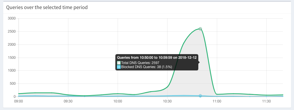

2018-12-12 10:59:02 PTR 183.37.13.10.in-addr.arpa mac.local
2018-12-12 10:59:02 PTR 184.37.13.10.in-addr.arpa mac.local
2018-12-12 10:59:02 PTR 185.37.13.10.in-addr.arpa mac.local
2018-12-12 10:59:02 PTR 186.37.13.10.in-addr.arpa mac.local
2018-12-12 10:59:01 PTR 174.37.13.10.in-addr.arpa mac.local
2018-12-12 10:59:01 PTR 175.37.13.10.in-addr.arpa mac.local
2018-12-12 10:59:01 PTR 176.37.13.10.in-addr.arpa mac.local
2018-12-12 10:59:01 PTR 177.37.13.10.in-addr.arpa mac.local
2018-12-12 10:59:01 PTR 178.37.13.10.in-addr.arpa mac.local
2018-12-12 10:59:01 PTR 179.37.13.10.in-addr.arpa mac.local
2018-12-12 10:59:00 PTR 167.37.13.10.in-addr.arpa mac.local
2018-12-12 10:59:00 PTR 168.37.13.10.in-addr.arpa mac.local
They all originate from my desktop mac.
Anyone tips on how to proceed?
I currently do not understand how and where fail2ban could help me...
Those are reverse lookups for the address 10.13.37.xxx. When a program or a daemon on the client tries to access another node on the network by IP address it will often try to do a reverse lookup so that it can display the FQDN of the node instead of just displaying the bare IP address.
Ah, thnx! I did not recognize my local network address-space (10.13.37.xxx)
Still kinda funky that my Mac suddenly wanted to scan the whole range (Which should be limited to 255 ip's) for, what seems to be, at least ten times.
