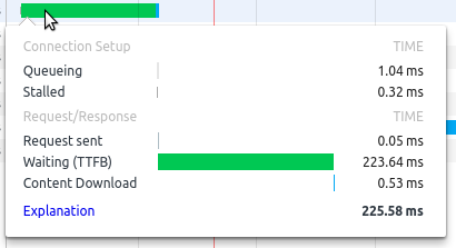

The response time with my Raspberry Pi B (Version 1) with a slow SD card and running some other stuff on it is on the order of 0.2 seconds. I think that is quite acceptable.

I don't also see this scale out for a bigger network. Say you have an apartment building with 20 households which all have a laptop, smartphone, tablet, etc. You then get all those useless 404 connections to the Pi, while you could just serve the NXDOMAIN DNS response and be done with every attempt in milliseconds instead of hundreds of milliseconds as you've shown.

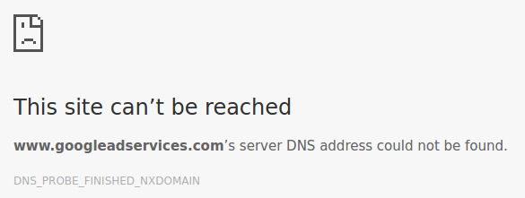

Responding with NXDOMAIN is not the same as responding with 0.0.0.0 or 127.0.0.1. In the last case it will result in more delay rather than less. An NXDOMAIN will directly inform the client that there is no content coming from the requested host, so any future requests will be omitted, resulting in a speed-up. It may indeed result in frowny faces here and there, but the speed increase is worth it.
I have implemented such an approach using bind (so without Pi-Hole) and it works great. No frowny faces (but I guess that's a Chrome thing), just empty space where ads would've been.

I've just tried the "BLOCKINGMODE=NXDOMAIN" setting and so far everything seems to be doing fine : domains from blocklists are still blocked, and DNS replies sent by PiHole for those domains are "NXDOMAIN" as expected, very nice, thanks !
