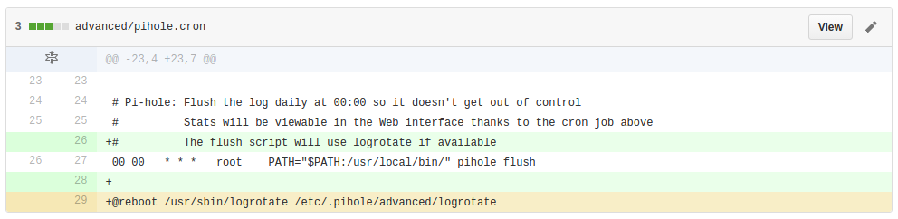

Timing might actually be an issue. We could do it with cron at midnight. What if the Pi is not running at midnight? Of course, there is the @reboot statement with cron: do you know if there is an option to do the logrotation only if it has not been done today? I hope you get what I mean. Pi-hole's not running 24h are seeing this issue and it would be nice if this approch would provide an elegant way to mitigate that problem.
https://github.com/pi-hole/pi-hole/pull/1130

I don't think your @reboot line in cron is doing anything. I've tested this, the way your github modifications specify and get a log entry (error - syslog). If you add the user (root), the log is flushed when the system is rebooted, actually no different from pihole flush.
The command line --force option actually instructs logrotate to rotate, no matter what the conditions are.
To test this, I used yesterdays log and simply copied it into todays log, I think I've covered all scenarios, even a non existing log (that should never occur).
@reboot root /opt/pihole/piholeLogFlush.sh reboot
The line --force is not there!
Sorry, I missed that, will need to test again, however, NOT seeing a username there, I'm getting an error
Jan 13 10:22:55 raspberrypi cron[368]: Error: bad username; while reading /etc/cron.d/pihole
Jan 13 10:22:55 raspberrypi cron[368]: (systempihole) ERROR (Syntax error, this crontab file will be ignored)
Jan 13 10:22:55 raspberrypi cron[368]: (CRON) INFO (Running @reboot jobs)
Okay, so both of us have found something. It seems that I really have to do add the user there for Raspbian (that is not necessary under Ubuntu, where it defaults to root).
