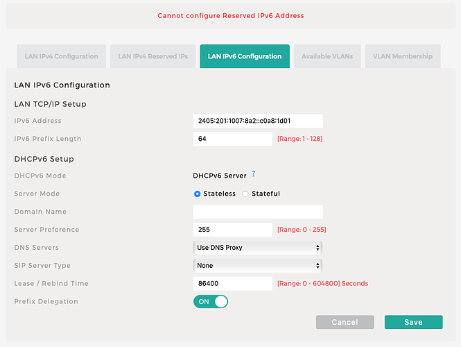

You are right. The router is an ISP provided one and it has its own IPv6 address which is the one I see in the post above.

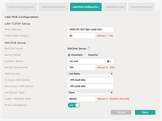

I tried converting my Pi-hole IP to v6 and setting it here but then it won't let me since I had reserved this IP in the v4 configuration! I guess there is no getting past this.
The following command will give you a list of currently assigned IPv6 addresses when run on your Pi-hole host machine:
ip -6 address
I'd guess you should try to set one of those addresses as DNS Servers under DHCPv6 Setup (and most likely not as IPv6 address under LAN IPv6 Configuration), but please consult your router's documentation and/or support for further details.
I turned off IPV6 in my router (provided by the service provider). The blocking seems to have worked now. When I run nslookup pi.hole I now see the IP of my Pi-hole server and nslookup flurry.com shows me 0.0.0.0 as expected.
