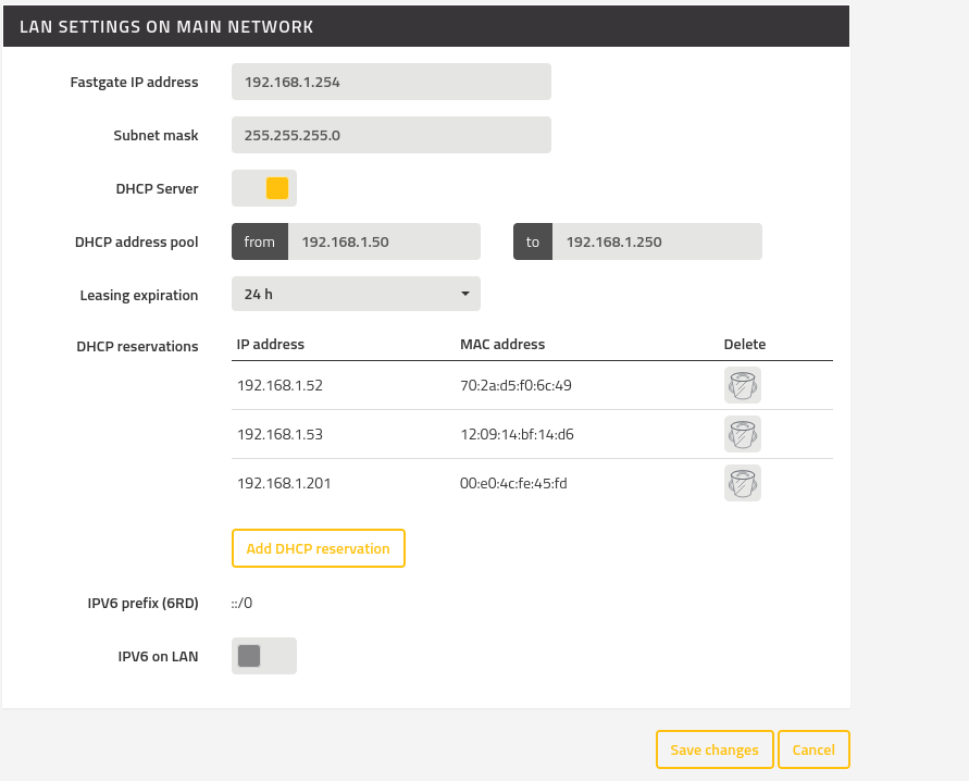

bro this is my setting please let me know what ip made i change it
You haven't shown the DNS settings on the router.
Is this a Fastweb Fastgate router? It may be that on this router the DNS is set automatically by Fastweb and you cannot change it. From a forum post
Translated
"unfortunately with the FASTGATE there is no way to change the primary and secondary DNS as Fastweb with its DNS would guarantee better control from potential malware capable of tampering the router as happened in the past for many routers including those of some well-known telephone companies. The downside of the coin is when you need to filter the contents of the traffic such as is done with Open DNS. In this case, unfortunately, you have to change the DNS for each device connected to the router ..."
Have a close look at every page and option and try to find the DNS setting.
