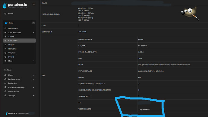

i have similar to your problem.
I'm running pi-hole as docker container too, i forgot my password and i reset it again, but every time i have to login i reset the password
and i found the solution to my problem,
logged in to portainer to check the container and i found that when i set the container the first time i typed the the admin password in the environment variable WEBPASSWORD= i.e-mypassword
