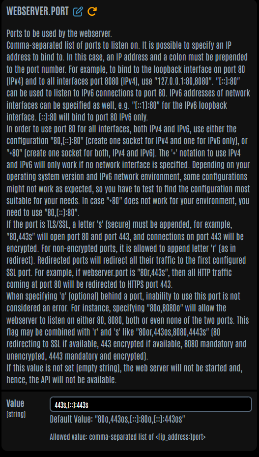

What finally worked was editing /etc/pihole/pihole.toml so port = "80or,443os,8080,4443s" although I don't use https.
Your configuration is not wrong, but it is a little unorthodox.
You set 2 ports for http (80 and 8080) and 2 ports for https (443 and 4443), but all ports use IPv4. No IPv6 ports were added. Was this intentional?
The default settings use 80 and 443, IPv4 and IPv6: "80o, 443os, [::]:80o,[::]:443os"
(o means "optional". You can remove it if you know your server doesn't use other web server).
I check that, because it suggested the interface go to https and paradoxically it don't enter at the beginning then ask me for this, and by the way maybe I will redirect that internal port as I have started do with my NAS and home automation server.
Where do you edit the port line? Is it indifferent or under the upstreams?
You can either edit the port line in /etc/pihole/pihole.toml or in the Web interface
All Settings > Webserver and API > webserver.port when in Expert mode.

When removing the o FTL will throw an error if it cant bind to that specific port, this may be helpful if you really need the specific port.
If this configuration is unorthodox, then why is it provided as an example?:
  # ... This flag may be
  # combined with 'r' and 's' like "80or,443os,8080,4443s" (80 redirecting to SSL if
  # available, 443 encrypted if available, 8080 mandatory and unencrypted, 4443
  # mandatory and encrypted).
My attempts at concocting this setting have failed, so until the ideal permutation becomes clear, I'm sticking with this.
Omitting IPv6 is intentional, as I disable it globally.
