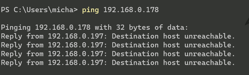

I cannot SSH into my Raspberry Pi 4 Model B+ that is using a Pi-Hole several days ago I can perfectly SSH into it, I have it configured raspi-config SSH enabled.
I tried to ping it

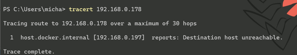

finally traceroute it but I don't have docker installed in there, why is this happening?
is this my PC docker?

The "Destination host unreachable" message means your PC was not able to connect to 192.168.0.178.

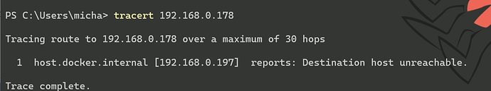

The name host.docker.internal was locally answered by Windows (not by your unreachable Raspberry Pi).
host.docker.internal is a special DNS name used by Docker. This name resolves to the internal IP address used by the host machine (Probably your Docker Desktop for Windows).

No. I have no idea why host.docker.internal appears on your tracert, but Docker has nothing to do with your issue.
The problem is your windows machine can't reach your Raspberry Pi (192.168.0.178).
Did you try to ping 192.168.0.178 from other devices? Does it connect?
Are you sure your Raspberry Pi is connect to the network and running?

The machine you ran your ssh and ping from either has no route to your RPi at 192.168.0.178, or that RPi is down or disconnected.
