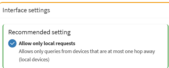

I think your issue is your Pi-hole is on a different network (192.168.90.2/24) than your PC (I'm guessing it is 192.168.20.101) and you configure Pi-hole to listen only local requests (DNSMASQ_LISTENING=local).

I have a setup similar in that my Pihole is on one network (192.168.3.0/24) and other VLANs are on 192.168.1.0/24, 10.10.5.0/24, etc. I had the same problem you describe initially, but change the Interface settings to "Respond only on interface eth0" fixed it, since ultimately all LAN DNS traffic is going through my RPi's ethernet port.
Note that your "...interface..." may have a different name from mine.
