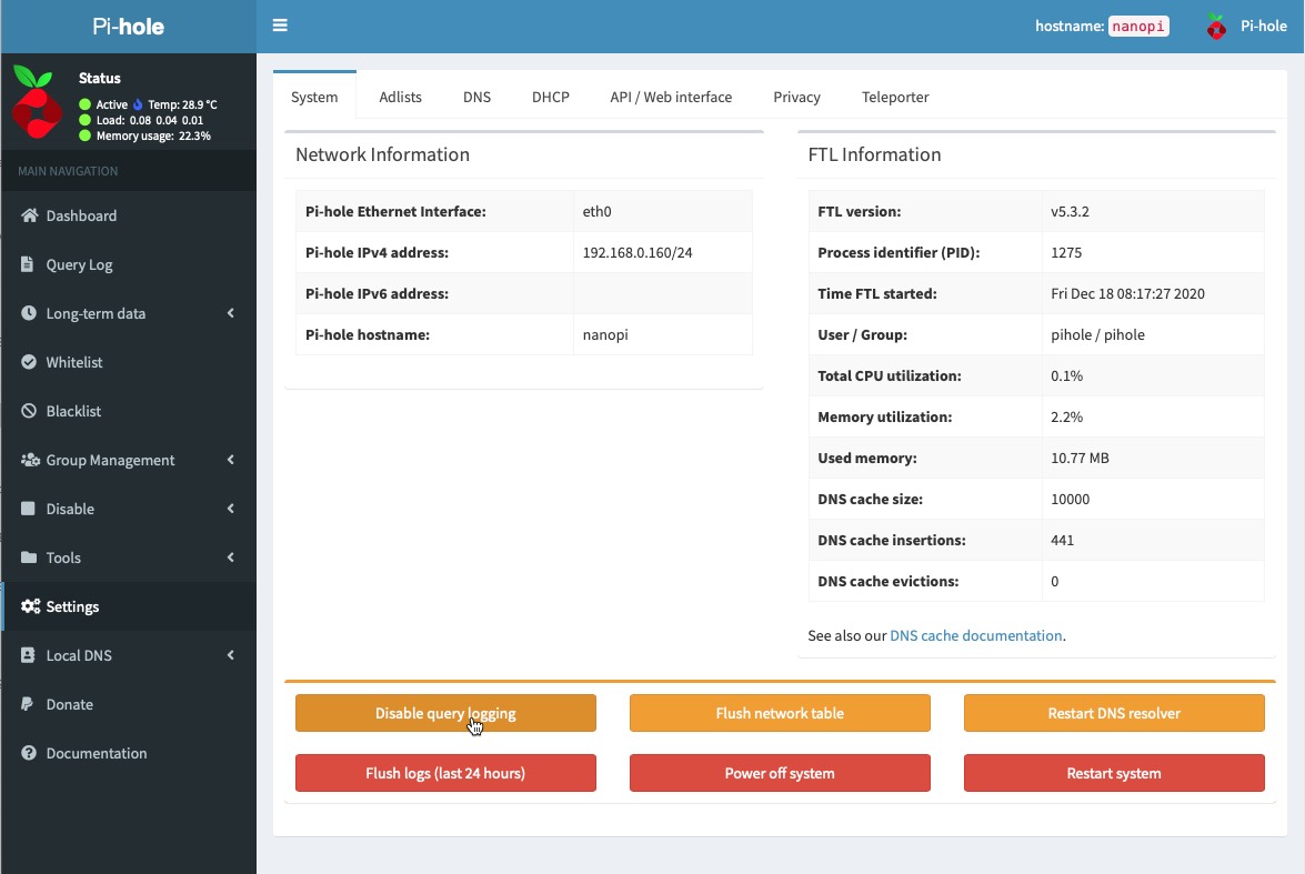

There is a setting in Pi-hole to disable logging, which will turn off this particular dnsmasq log file. But, given the relatively small size and temporary nature of this log, I would leave it enabled. As you have seen, it provides some pretty good insight into client DNS activity.
Disable query logging on Web GUI > Settings:
The dnsmasq log is completely separate and independent from your long term database. If you disable the dnsmasq log, the primary impact is that you won't have a log to live tail, and some details of the queries will be lost (they aren't stored in the long term database). Your dashboard will be unchanged, as that is populated from the long term database.
