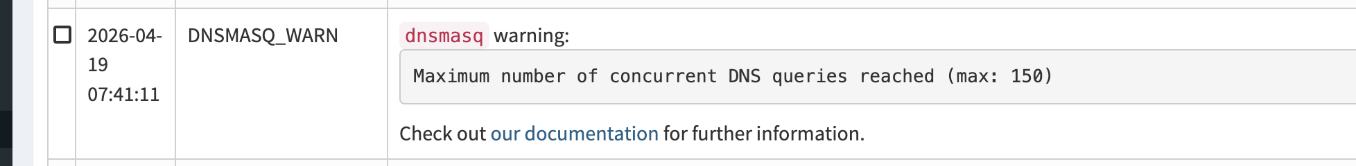

Hello, I recently installed pi-hole. It is a great tool to not only block unwanted content, but gives some great insight into your network that goes otherwise unnoticed. I have a single Hubitat devices on my network and I am seeing the error "Maximum number of concurrent DNS queries reached". This is the only device throwing this warning - everything else looks good. Could anyone help me understand the message and if/what may be done to address it? Thanks so much in advance for any guidance here.
Did you read that link from the screenshot "Check out our documentation ..."?
Check the DNS Queries it has been sending to your Pi-Hole and you might find out what is causing all this let’s say “DNS SPAM” :slight_smile:

I added the domain name that seemed to be causing the issue to my “allowed” list and things have quieted down. Thanks for the feedback, greatly appreciated.
