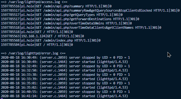

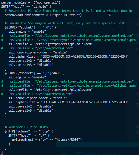

There are no errors in systemctl status but when I try to access the web interface it won't load. I'm using mkcert for the certificate and replaced noads.dehakkelaar.nl with pi.hole. I also tried adding the rootCA.pem file from mkcert but that didn't work either.
Tail the logs live while running the curl command:
sudo tail -f /var/log/lighttpd/{access,error}.log

I added the mod_openssl line because running systemctl status lighttpd said it was missing.
I dont know whats bugging your setup now.
Am not familiar with mkcert.
And you deviate from whats common practice with wanting to have TLS/SSL without a domain name (common name or SAN).
The 301 reply in the logs means lighttpd is redirecting.
The curl command should tell you more about redirecting where to eg:
curl -IvkL https://localhost
curl -IvkL https://[::1]
curl -IvkL http://pi.hole
curl -IvkL https://pi.hole
For above curling to pi.hole to work on the Pi-hole host, nameserver in /etc/resolv.conf needs to point to 127.0.0.1:
