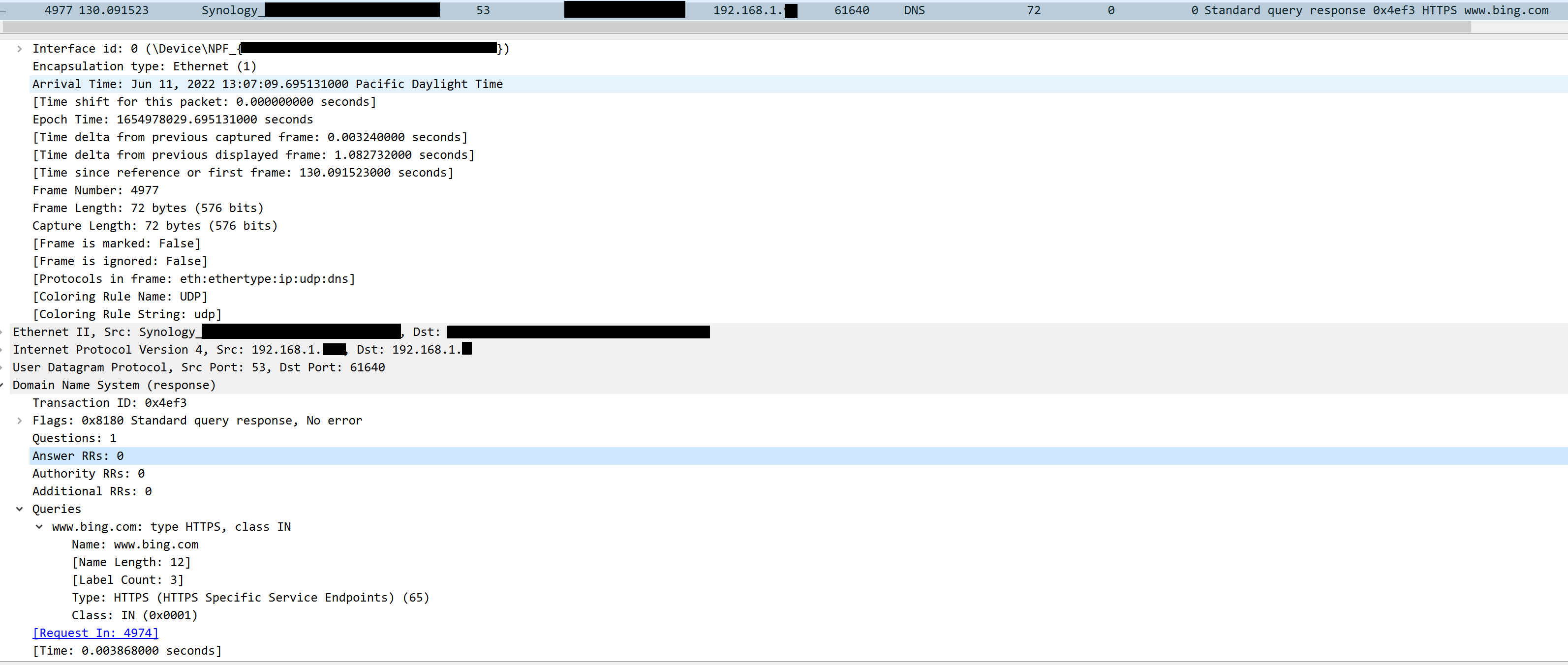

Expected behavior (determined by comparing 8.8.8.8 responses in wireshark) would be to always reply with a SOA record in the reply, and also return the associated CNAME record returned from upstream when available. Wireshark shows this not happening reliably. I have tried, but am unable to pinpoint an exact cause.

Wireshark / monitoring setup: I have a unifi 8-port POE switch connecting my wireless AP. I have a USB ethernet adapter connected to a second port on the same switch and set to mirroring mode for the port the AP is connected to. This USB adapter is connected to a pc with wireshark and has all TCPIP disabled on the adapter, with only NPCAP enabled on it, so that its only function is to mirror packets to/from the AP into wireshark.

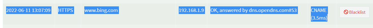

For the screen-shot shown below, limit IP address tracking is set to off... however, I have not found that setting makes a difference for the behavior claimed in this topic. The only thing that changes the behavior is whether I use the pihole as a dns server or not.
The Pi-Hole web interface confirms that for type65 / https queries that contain a CNAME entry, the upstream service does return the proper entry (queries that do not find a cname entry will show 'NODATA' in the response column).
I believe based on what the pi-hole UI is showing that it receives a CNAME record in response to the forwarded query.
However, the response actually returned to the client is not including the CNAME record, nor is including a SOA record either (which should always be present in the response for this query).
(Note the time-stamp in the images to correlate the two queries between wireshark and the website.)

My guess would be that the difference is caused by the upstream DNS resolver. You configured Pi-hole with a lot of different upstream servers

Looking at your Query Log screenshot you can see that OpenDNS returned the CNAME. As you made all your test by comparing to 8.8.8.8 I would suggest you use only this one as Pi-hole's upstream and see if you get the same response as querying 8.8.8.8 directly. Afterwards, change to OpenDNS only and see if the behavior changes.

Yes, as you mention, the pi-hole UI image does show a CNAME returned in that specific example.
However, I need to point out that for the same compared query response (the wireshark image shows the exact time-stamp), I believe that pi-hole is stripping the returned CNAME from the reply to the client even though the upstream server included it.
Yes, I did go on and make further comparisons in another image, I understand your reply in terms of the broader comparison.
However my specific concern / report is that Pihole seems to be stripping the CNAME from the reply back to the client even in the cases where the upstream server includes it.
