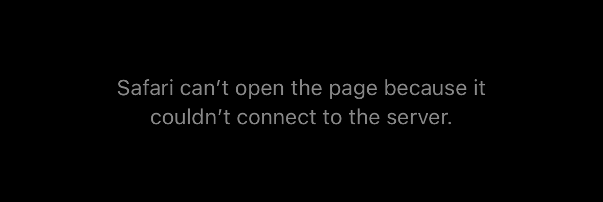

I should add - have tried multiple devices, multiple browsers. My network has 2 pihole devices. This is my secondary. The other is still on v5.

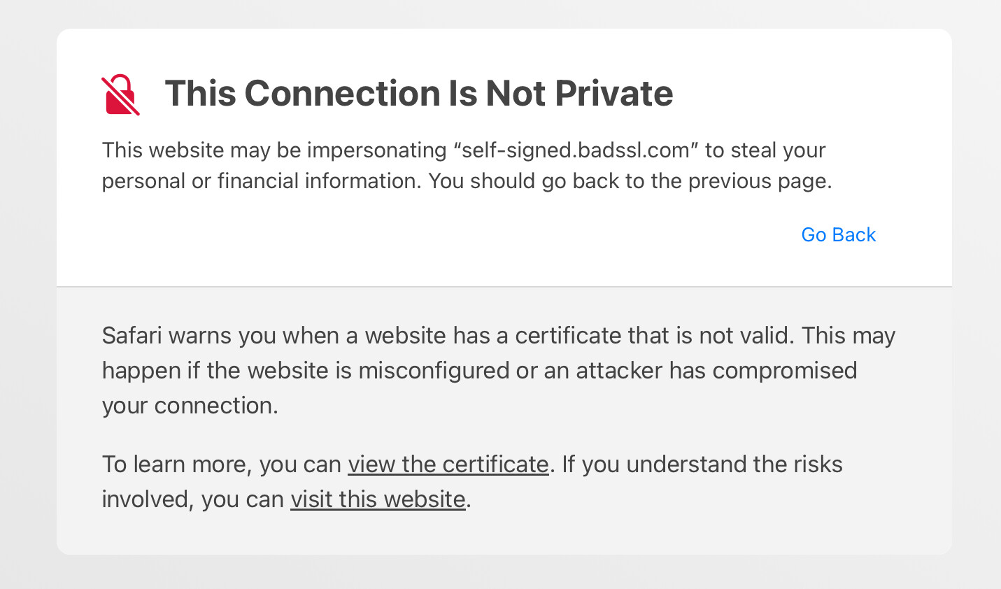

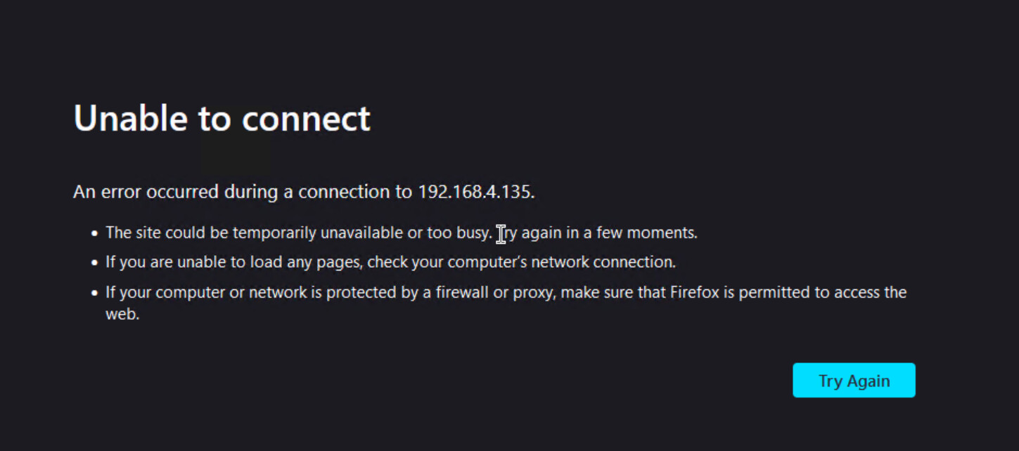

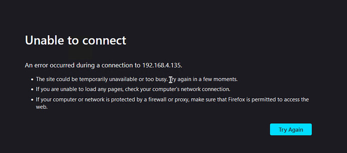

How do the error messages look like in the other browsers you've tried? Maybe Safari simply isn't happy with the self-signed certificate? Maybe you need to add some exceptions somewhere (I am not familiar with Safari).
That’s from Firefox in windows.

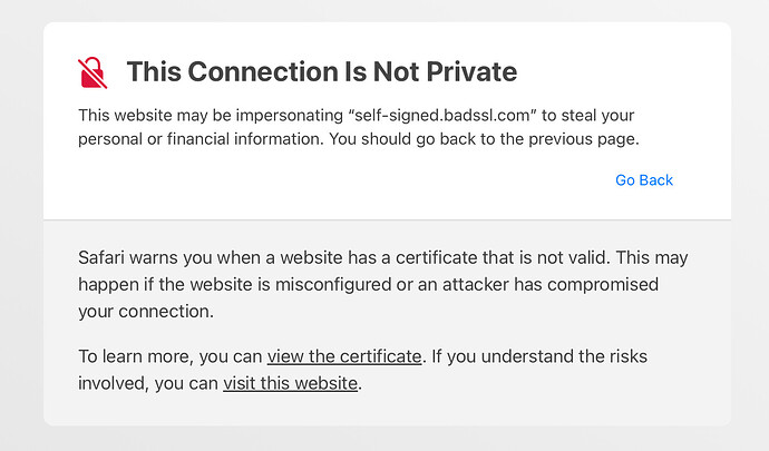

I’ll try and reinstall one. It’s strange that I’m not getting an SSL error if that was the problem, though
One like this….
