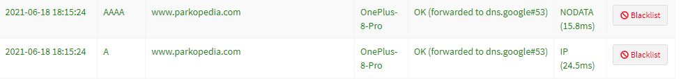

This seems like a simple straightforward thing, but I am new to this and I couldn't find much information related to this topic. I installed pi-hole on my raspberry pi4 and configured my android phone to use the dns server provided and it seems that after that all https traffic ends in error, even when I disable the pi-hole. Is this the expected behavior?
From the logs:
Jun 18 15:34:52 dnsmasq[12909]: query[A] www.parkopedia.com from 192.168.1.128
Jun 18 15:34:52 dnsmasq[12909]: forwarded www.parkopedia.com to 8.8.4.4
Jun 18 15:34:52 dnsmasq[12909]: query[AAAA] www.parkopedia.com from 192.168.1.128
Jun 18 15:34:52 dnsmasq[12909]: cached www.parkopedia.com is NODATA-IPv6
My understanding is that NODATA-IPv6 is a form of blocking sites. Is my configuration wrong that makes all https requests fail?
Please help, where should I look to fix this?
HTTPS websites should display properly.
HTTPS websites end up in error with address unreachable
https://tricorder.pi-hole.net/rz2idk50of
From this log I take it it should work, but it doesn't.

This does not appear to be a Pi-hole issue. Pi-hole resolves domain names to IP's. Once the client has the IP, then the client makes the connection to the domain, which would include any TLS or SSL connections to the requested domain. Pi-hole is unaware of any traffic or connections made by the client to any resolved domains.
Pi-hole is resolving the domains, so the problem lies outside of Pi-hole.
Of interest, the queries are coming to Pi-hole from an IPv6 client address. Is the client in question configured to connect to IPv6 only, or can it connect via IPv4 as well?
The client is an Oneplus 8 Pro, with the default android wi-fi settings, except the dns server override.

That client has both an IPv4 and IPv6 address. Since Pi-hole is resolving the domains correctly, the problem is with the requesting client.
On that client, check the SSL certs. If those are bad, it won't be able to make an SSL connection.
I'm puzzled since it works if I remove the dns override.
It seems it has something to do with how Android network configuration works. On my win10 machine, it works with no issues, both on ipv4 and ipv6.
As a workaround, it seems that using an app called DNS Changer and setting it to my pi-hole actually fixes the issue. I hope this helps someone else who might come to this issue in the future.
