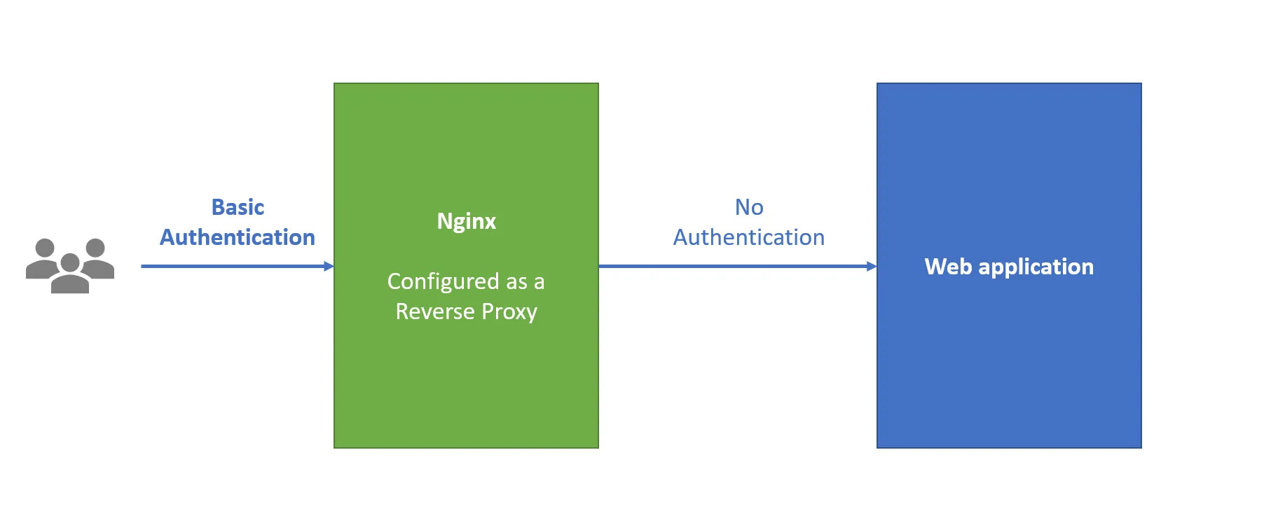

On another note: Reading a bit on the Internet about "IAM" and "nginx" typically leads to a solution where no authentication is used on the target. Now, I am not actually sure we need such a feature in Pi-hole at all and I am more inclined to a "No" right now, cfm. the following schema:
(source)
This makes a lot of sense. You authorize on the reverse proxy level and only those that are authorized make their way through to your Pi-hole. Making your nginx the central IAM node allowing you to have an arbitrarily complicated user management.
