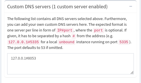

And via the web interface:
127.0.0.1 is the loopback address, pointing back to a machine itself.
In case of a dockered Pi-hole, that's the Pi-hole container itself, where nothing is listening on port 8053.
You need to point Pi-hole to your unbound container's IP address, which can be unbound's Docker internal IP.
If you are using that, Pi-hole can talk to your unbound container on port 53, where your unbound is listening, without requiring exposure of a remapped port.
You should consider pointing FTLCONF_dns_upstreams in your Pi-hole container's environment section to your unbound container. You can do so by using that container's name, e.g.
FTLCONF_dns_upstreams: 'unbound'
Verify that you didn't configure your unbound installation within the container to listen on different ports, as your previous post may suggest you tried to accomplish:
You want to revert those settings and/or start with a freshly created default unbound container.
