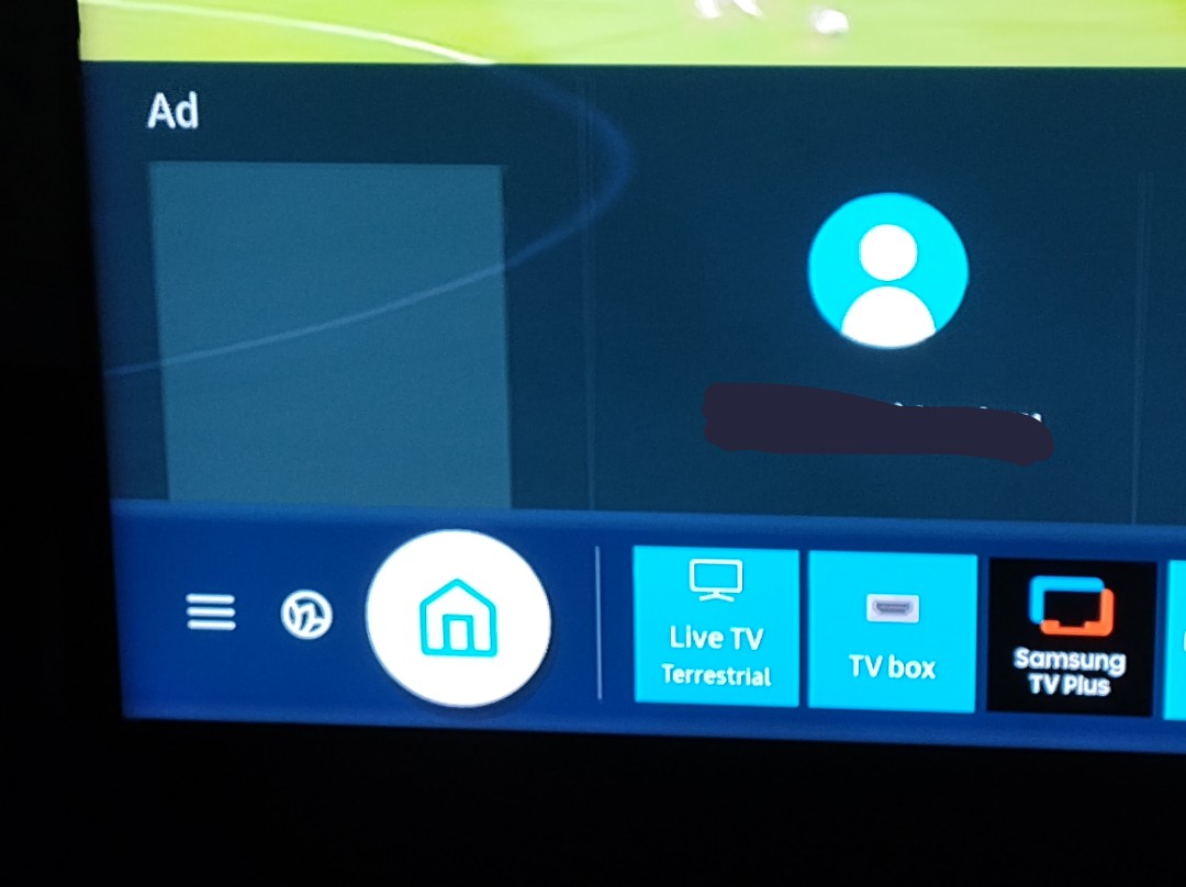

But, lately, on Samsung TV, when I hit Home button, sometimes, seldom, I get Samsung's advert to the left of home icon on screen, either with colour image, or, blank background.

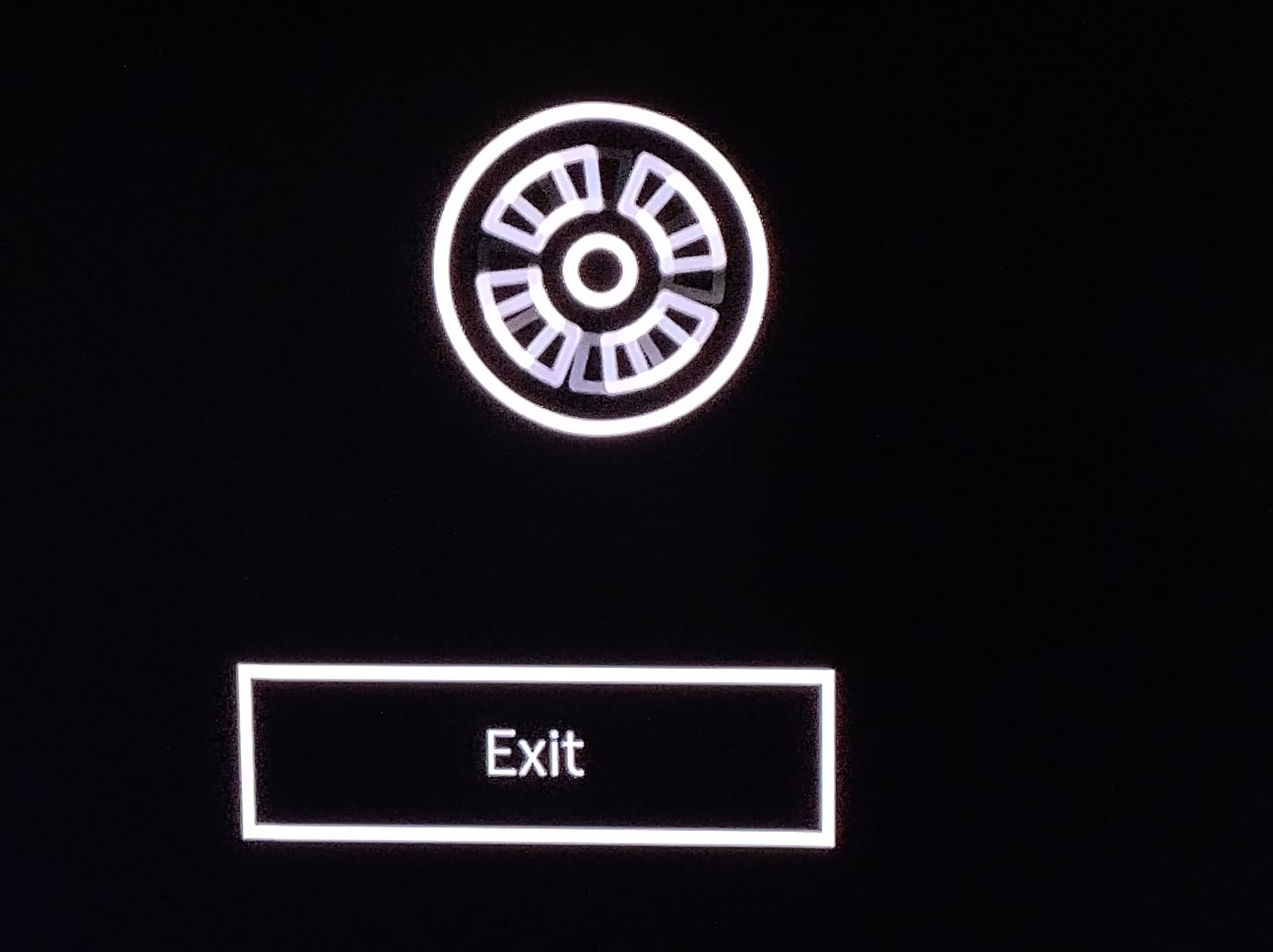

When I've tried to action that, got an image/ icon on screen (that I can't duplicate now, sorry) that won't load anything, times out.

It's normal to find that even when an advert is blocked, the 'container' which holds it is still rendered. In your case it looks like sometimes an advert is loaded, and you see the image in there, or the advert is blocked and the container just displays a blank background. It is analagous to how sometimes on a web page you see a big blank area where the advert would have been if Pi-hole hadn't blocked it.
If you've never seen this behaviour until now it may be that Samsung have updated the TV's OS and this is the new behaviour. Perhaps it tries to display an advert every few times you return to that screen, causing you to see the container.
I found another Smart TV blocklist which has a few extra Samsung ad-related domains which the Perflyst one doesn't have, and it seems to be maintained, so perhaps newer ad domains introduced by Samsung are being blocked. Worth adding to the mix to see if it helps. If so, it would prevent the images appearing, but the blank container with Ad written above it I think is going to keep showing up now and again.
