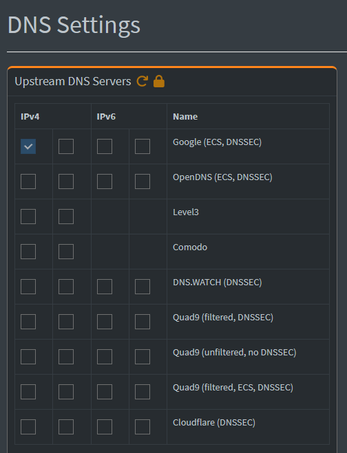

Problem already for me is that i cant set Upstream Server via GUI:
According to the Github I should set the Upstreams via Docker Compose:
  FTLCONF_dns_upstreams: '8.8.8.8'
But once i set this, i cant modify it via GUI. And IF i remove the top env variable, the docker container doesnt start properly
Where is my mistake?
Thanks

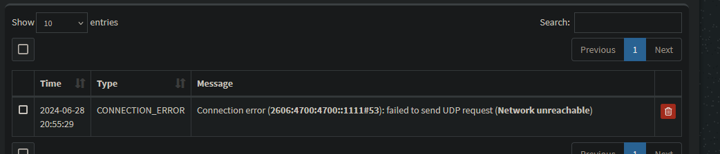

EDIT: When i add ipv6 to my docker, i get an error:
FTLCONF_dns_upstreams: '1.1.1.1;1.0.0.1;2606:4700:4700::1111;2606:4700:4700::1001'
That connection error (Network unreachable) is expected, as Docker is IPv4 only by default.
You'd have to explicitly enable Docker's (still somewhat experimental) IPv6 support for your Docker daemon as well as any of your containers that should use IPv6.
Note, however, that commonly, IPv4 would be sufficient for Pi-hole's operation.
Not for your aspired use case - the documentation explicitly states (emphasis mine):
The existence of this environment variable assumes this as the sole management of upstream DNS.
So if you want to select upstream DNS servers via Pi-hole's admin UI, your docker configuration should not declare FTLCONF_dns_upstreams at all.

v6 is just more verbose - v5 may just not have complained about an IPv6 upstream being unreachable, while DNS resolution would still work as long as there's at least one reachable upstream. The latter should also be true for a v6 container.
However, if your IPv6 address would be your Pi-hole's only upstream, you wouldn't be able to resolve public domains - they'd all be REFUSED.

When Pi-hole is installed on bare metal - the install guide asks the user to select some pre-defined suggestions for upstream DNS, or enter their own. Of course this can be adjusted in the web interface at a later date if the user has chosen to mash enter all the way through the installer and wants to tweak their settings.
For the container... As pihole-FTL does not have a default value for the upstream, we need to ensure that it is set before runtime. This can either be via environment variables or maybe even a pre-seeded /etc/pihole/pihole.toml via a volume mount. I guess we should add some verbiage to the Readme to clarify this.
If FTL had a default value for this setting (i.e 8.8.8.8;8.8.4.4) then we would not be having this conversation. But there are very good reasons why this setting does not have a default value - namely we probably don't want to infer support for one upstream over another (despite needing to be fairly explicit about it in a Readme as a suggestion to somewhat lower the barrier to entry)
In other words, if pihole v6 is being run via Docker Container, there is no way to configure the DNS Upstream Servers via GUI anymore.
Fine with me aslong it is documented that it is mandatory to set now upstreams via docker directly.
Thanks!
Preparing a commit that will default the value to 8.8.8.8,8.8.4.4 if nothing is explicitly set in the environment variable. Looking over the current state of the v6 Readme, I can see it infers that this is already the case anyway.
