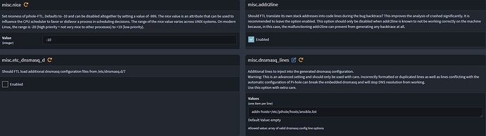

That file has moved to /etc/pihole/hosts/custom.list, but it would be overwritten on interaction with its UI, as prominently disclaimed in the file's header section.
To keep your existing file, try moving and renaming it to /etc/pihole/hosts/ansible.list, then tell Pi-hole to use it by entering the following line into misc.dnsmasq_lines via All Settings | Miscellaneous:
addn-hosts=/etc/pihole/hosts/ansible.list
The drawback of this approach is that you won't see any UI for it, but you can verify that DNS records exist by querying your Pi-hole for them.

Edit: Just noticed the edit by @Bucking_Horn, it indeed works but it's not reflected in the UI.
Which isn't a big deal.
Is it safe to remove the other entries that do show up in the UI as they are now "duplicates"?
