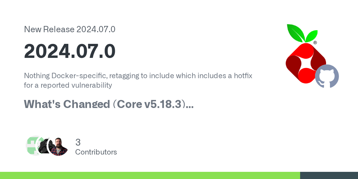

I am guessing that finding some old Docker Container of Pi-Hole v5 is your only option...
You want this Docker version - last of the V5 releases in Docker.
