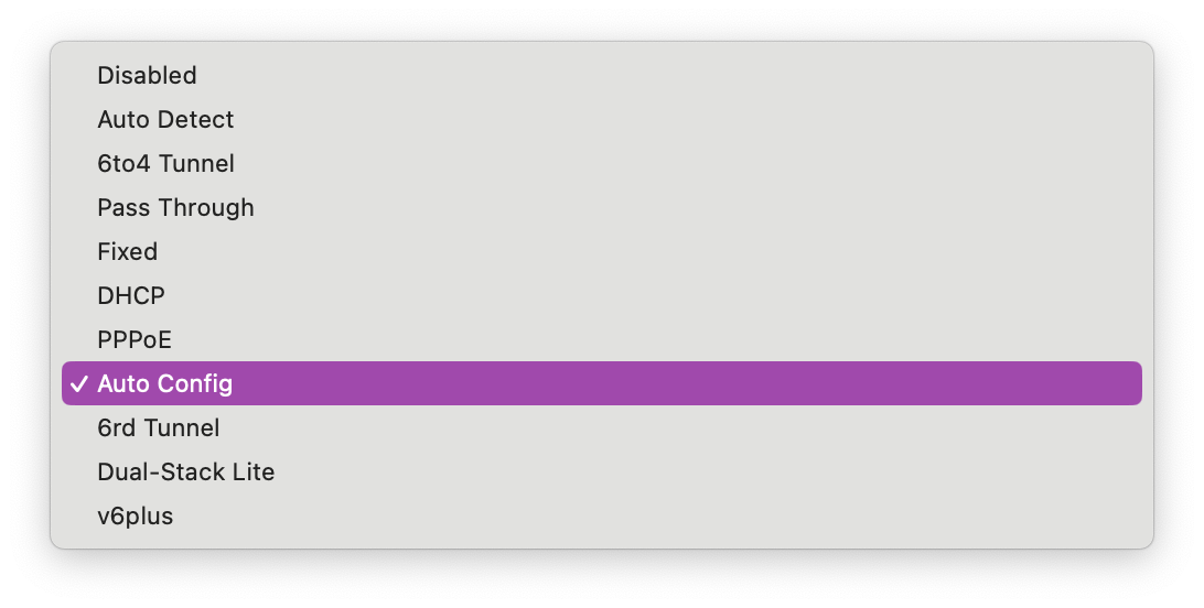

I found this thread on a whim where the poster EG's first reply said, "Generally, you should use Auto-Config." Given this, I looked again in my router's interface in the IPv6 settings and opened the drop-down for "Internet Connection Type" seen below. Sure enough, there is an "Auto Config" option.
Previously, I was using "Auto Detect" and I had also tried "DHCP". I went ahead and tried the "Auto Config" and hit Apply. Voila! :tada: I checked my devices' DNS settings, and they now have only the IPv4 and IPv6 DNS resolvers I manually specified in the router config. Both of these point to the Pi-hole's host machine. The Comcast resolvers are gone.
Of course, I am not sure of the underlying mechanics here or what the difference between "Auto Detect" and "Auto Config" really means, but so far this seems to have resolved the issue for me. I'll report back if this changes.

It would seem -let's say- unexpected that changing an option for your router's external "IPv6 Internet Connection Type" would have an impact on your internal private network's DNS configuration. But that's also the reason why I can only defer to the router's documentation and support for its IPv6 DNS configuration - it's just too cryptic to guess what they mean, even with screenshots. :wink:
For now, I'll keep my fingers crossed that it does what you want. :crossed_fingers:
I agree it's unexpected! The manual doesn't seem to give a whole lot of detailed insight on how this works. https://www.downloads.netgear.com/files/GDC/RAX200/RAX200_UM_EN.pdf
