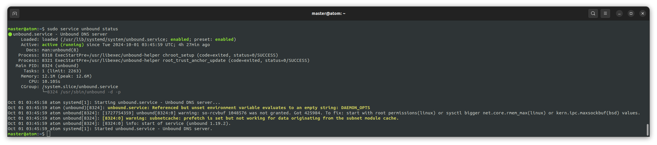

I have installed pi-hole on a dedicated acer atom notebook x64 that is installed with ubuntu 24.04.01 server using command sudo curl -sSL https://install.pi-hole.net | bash per documentation. I have also installed unbound and have them both running. However, I noticed 3 warnings in unbound.service.
How do I rectify those warnings?
No unbound.service warnings.
Although Pihole and unbound are both running (can block ads and function as a recursive DNS), there are still three unbound.service warnings that I don't know how to fix.
https://tricorder.pi-hole.net/GcDbA5uy/
The 2nd warning is due to line 58 of /etc/unbound/unbound.conf.d/pi-hole.conf:
# Ensure kernel buffer is large enough to not lose messages in traffic spikes
so-rcvbuf: 1m
I did not understand why the requested resource is not granted given that the system has available RAM.

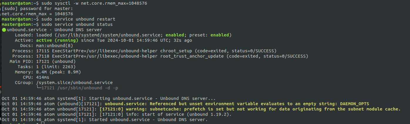

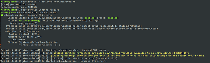

I came across a similar question posted on AskUbuntu and tried its answer which worked. Below is what I did. The 2nd warning no longer appears.

Had the same problem with the second issue, with subnetcache: prefetch. Disable “prefetch: yes with prefetch: no”, in /etc/unbound/unbound.conf.d/pi-hole.conf, this will solve the issue with cache.
This actually isn't the solution. Turn it back on to yes. If you cannot live with the warning, it does no harm, you need to disable the subnetcache module, which is enabled by default.
You can check which modules are enabled by executing this:
$ sudo unbound-control status
version: 1.17.1
verbosity: 0
threads: 2
modules: 3 [ subnetcache validator iterator ]
uptime: 253177 seconds
options: reuseport control(namedpipe)
unbound (pid 76437) is running...
Create a new file :
sudo touch /etc/unbound/unbound.conf.d/modules.conf
and add this content:
server:
    module-config: "validator iterator"
Next, restart unbound:
sudo systemctl restart unbound.service
and confirm that only those two modules are loaded:
version: 1.17.1
verbosity: 0
threads: 2
modules: 2 [ validator iterator ]
uptime: 531 seconds
unbound (pid 80384) is running...
Now the warning won't show up anymore.
Thanks for the feedback. It works.
In short, you don't have to do anything for those warnings :slight_smile:
