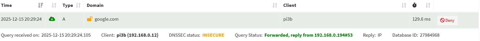

Just go to the Query Log page on the web interface and look for the query.
If you execute dig google.com and Pi-hole is the DNS server, the query will show up on the Query Log table.
Click on the table row to show the details:
In my example, the upstream server is unbound at 192.168.0.194. In your case, you will see 8.8.8.8.

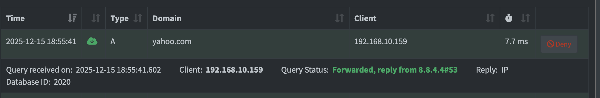

I executed dig yahoo.com and I did see a query in the log where it did forward to 8.8.4.4#53.
Is there any reason why I’m not able to capture that forwarded communication in Wireshark? Is there a way to capture network / vlan traffic instead of local interface network traffic? Also, if I install unbound locally on my raspberry pi and then change the upstream DNS to 127.0.0.1#5335, I should then see the traffic being forwarded to 127.0.0.1#5335 instead of 8.8.4.4, correct?
