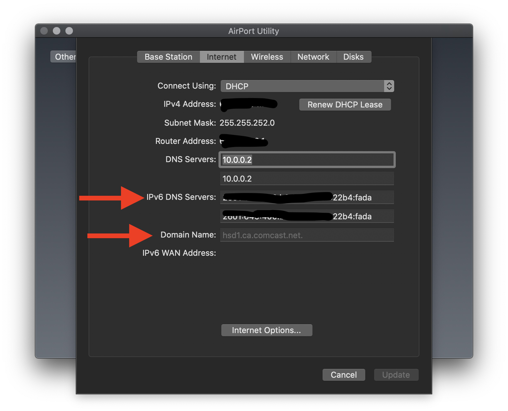

The AirPort Extreme has settings that I'm not sure how to map to my pi-hole
I've taken some screen shots of the settings that I'm not sure of and how they should be configured
Settings in question are:
ipv6 dns server(currently set to the ipv6 ip of pinhole)

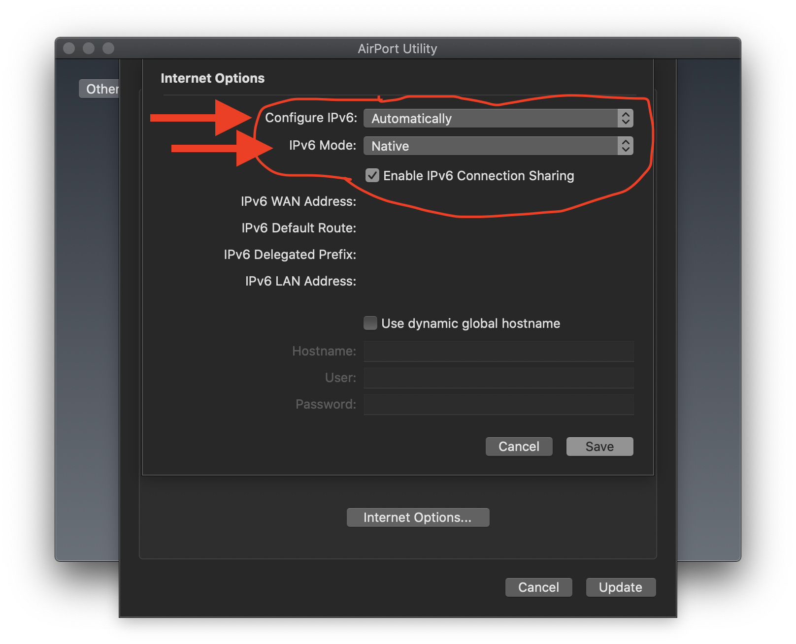

Domain Name: defaults to Comcast
Ipv6 Mode: Currently set to native
Configure IPv6: set to automatic

I too use Airport Extremes. My recommendation, if there is no compelling need for IPv6 on your network (and there rarely is), disable IPv6 by selecting Link-Local. This will greatly simplify your network management and avoid a number of potential IPv6 issues that may puzzle you greatly.

How to configure your Pi-hole with the AirPort Extreme base station is actually shown in one of the images jfb has already provided. You would enter your Pi-hole's IPv4 address as the first "DNS Servers" and its IPv6 address in the "IPv6 DNS Servers" slot. The key is to have already assigned static local IP addresses for your Pi-hole. You do NOT want your Pi-hole to have a dynamically assigned IP address.

I'm assuming that Comcast is providing you with IPv6 service. There are a few "flavors" of this type of service. Which kind exactly are they providing you? If they provided you with the correct IPv6 settings, you would enter them using the Configure IPv6 > Manually option. Otherwise, you would use the Automatic & Native settings.

The stuttering seems to happen whenever I enable ipv6 settings on the AirPort Extreme. If I remove the airport from my setup and just you the router built into the Plume then things work fine, granted I only have ipv4 addresses. If I set the airport to automatic and native mode for ipv6 I get an assigned prefix and everything seems to work except for the internet stuttering issue especially on things like zoom. I have 1Gib speeds so I know I should not be getting choppiness but when ipv6 settings are enabled the problem re appears. My setup is PiHole controls both DNS and DHCP AirPort Extreme only does the routing and NAT for ipv4 addresses. Plume Pods manage the wifi
