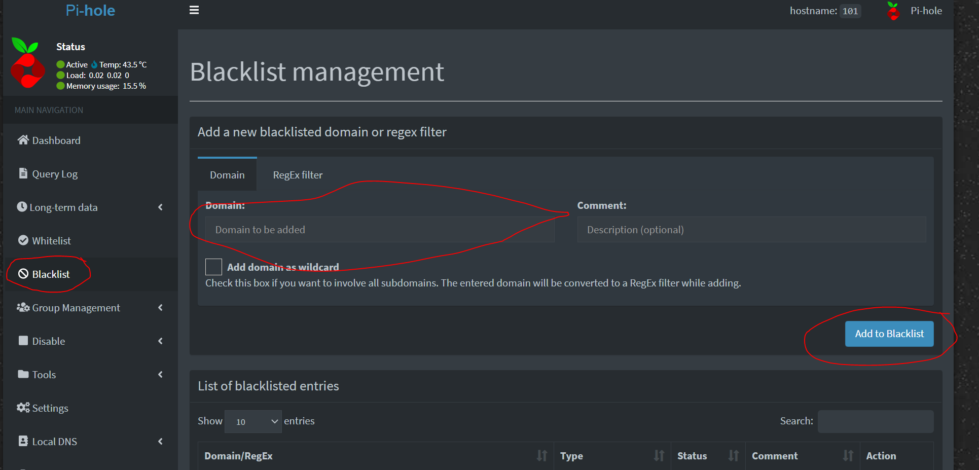

just blacklist this domain, what will happen ?

click 'blacklist', add the domain you wat to blacklist, click on the blue button
I now have (\.|^)rv\.sitename\.net$ added to the list, but the ads are still coming through.
Than the ads are likely not coming from this domain, but maybe from www.sitename.net/ads?
