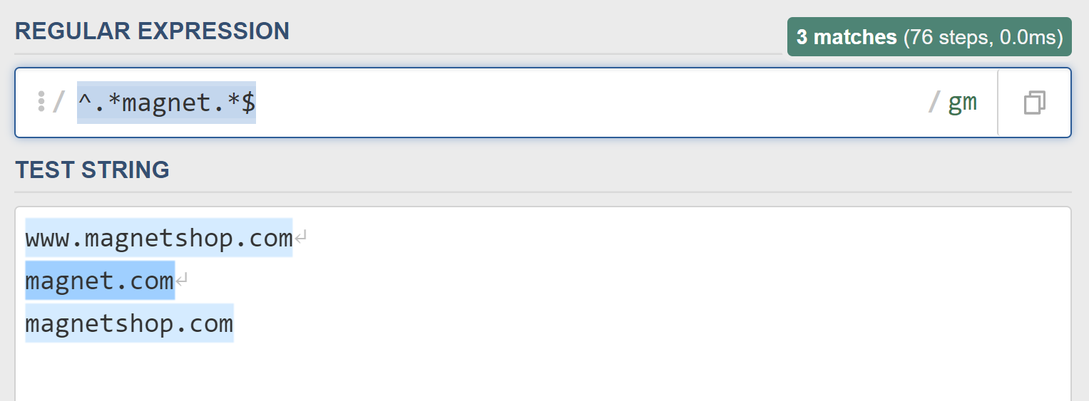

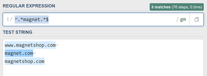

Use regex101: build, test, and debug regex to test your regexes.

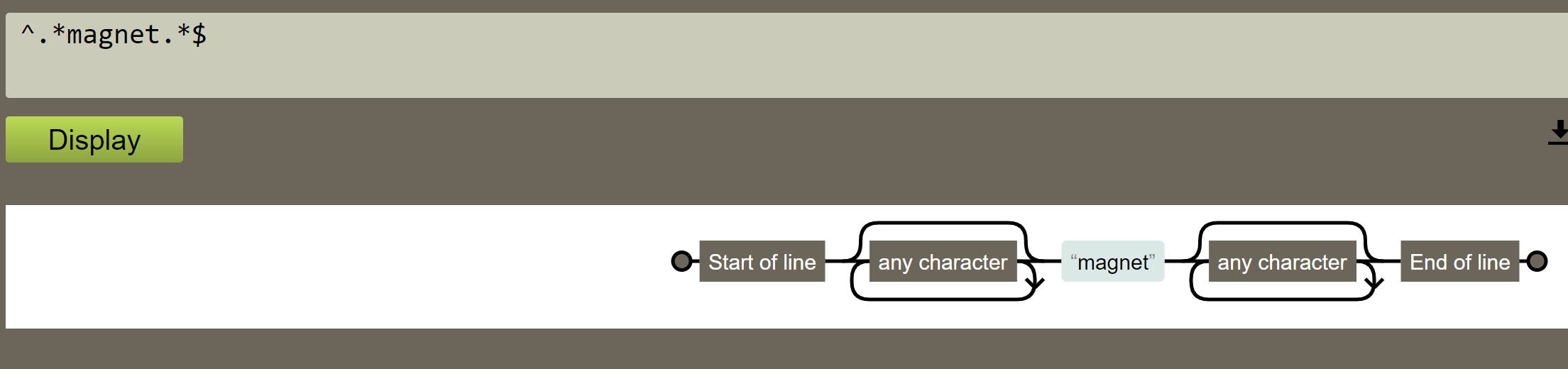

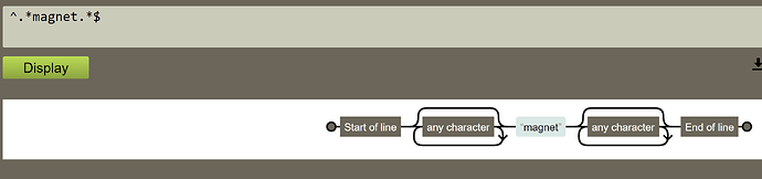

Even simpler:
magnet
being exactly equivalent to ^.*magnet.*$, however, much less work to be computed.
