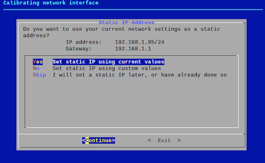

I was curious and did some testing here with a vm.
Using Ubuntu 22.04.1 server, Mint 21 desktop and Pi OS bullseye. Various cross-combinations of multiple NICs, single NICs, multiple IPs, single IPs. Networking via netplan rendered by network-manager in Ubuntu. Combinations of DHCP and manual configs.
Only on the Pi OS install was I shown this IP config screen
On all the other systems it went straight from the Static IP Needed screen to the Select Upstream DNS Provider screen. If there were multiple NICs it did that via the Choose An Interface screen. Either way it didn't show the above screen.
I don't know if this is normal or a bug or a change in the install process. It doesn't appear to be related to the use of netplan. I have installed Pi-hole on Mint before and am sure I was shown this screen. I have installed Pi-hole a lot on Pi OS and am always shown this screen.
In all cases I installed with the below
wget -O install.sh install.pi-hole.net
sudo PIHOLE_SKIP_OS_CHECK=true bash install.sh
