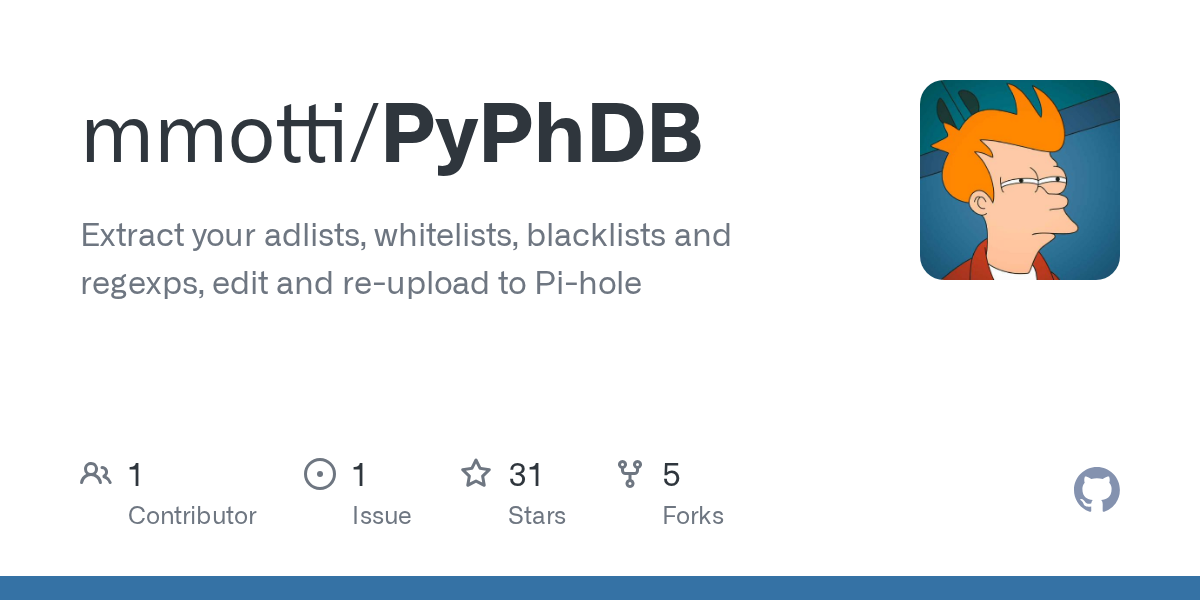

You could use a script that I've written to export as flat files, make changes and import again.
It just depends how adventurous you are.
